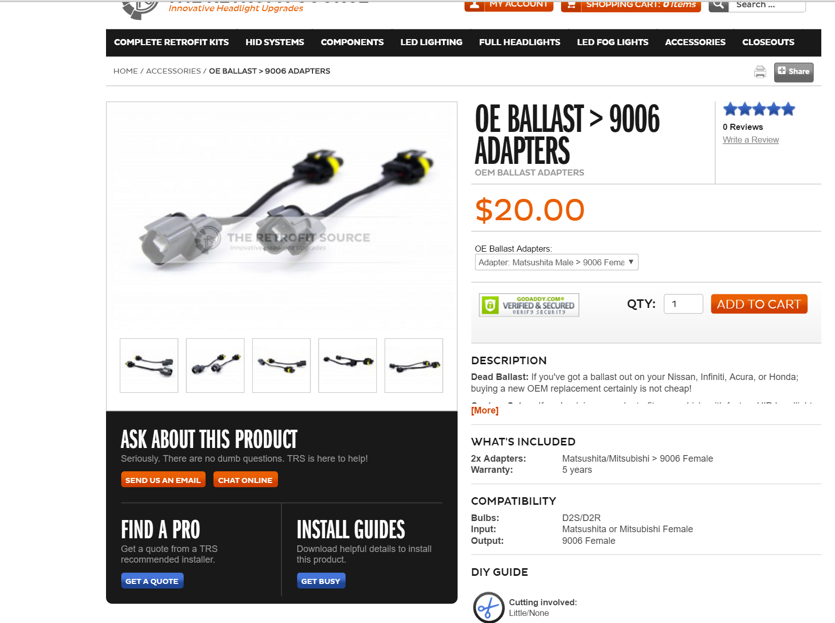

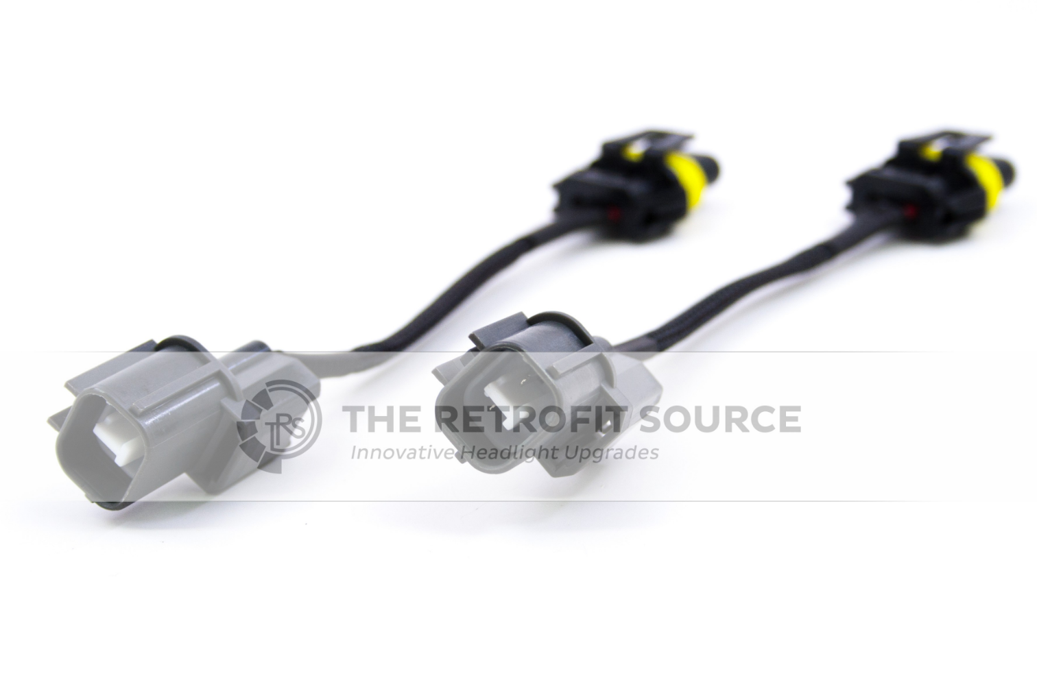

solution to convert oem harness to aftermarket ballast?
I think this is what we are looking for.. Retrofitsource has the adapters with a male end to plug in where the oem ballast went and then it converts to a female end to plug into an aftermarket ballast...
OE BALLAST > 9006 ADAPTERSOEM BALLAST ADAPTERS
https://www.theretrofitsource.com/ac...l#.VzfbNZErLid

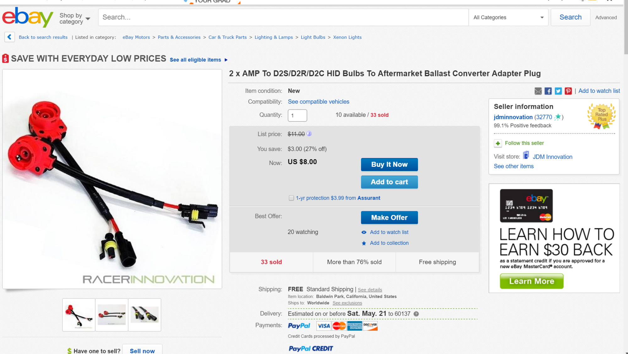

AND you can use this for the bulb conversion:
2 x AMP To D2S/D2R/D2C HID Bulbs To Aftermarket Ballast Converter Adapter Plug
all the plugs match up..what do you guys think?

The retrofitsource adapters you posted are correct, they've had those for a few years now.
I never ended up swapping out my OE ballasts for 50W or 55W ones. 30W/35W are more than enough and I saw no reason to replace perfectly good ballasts
