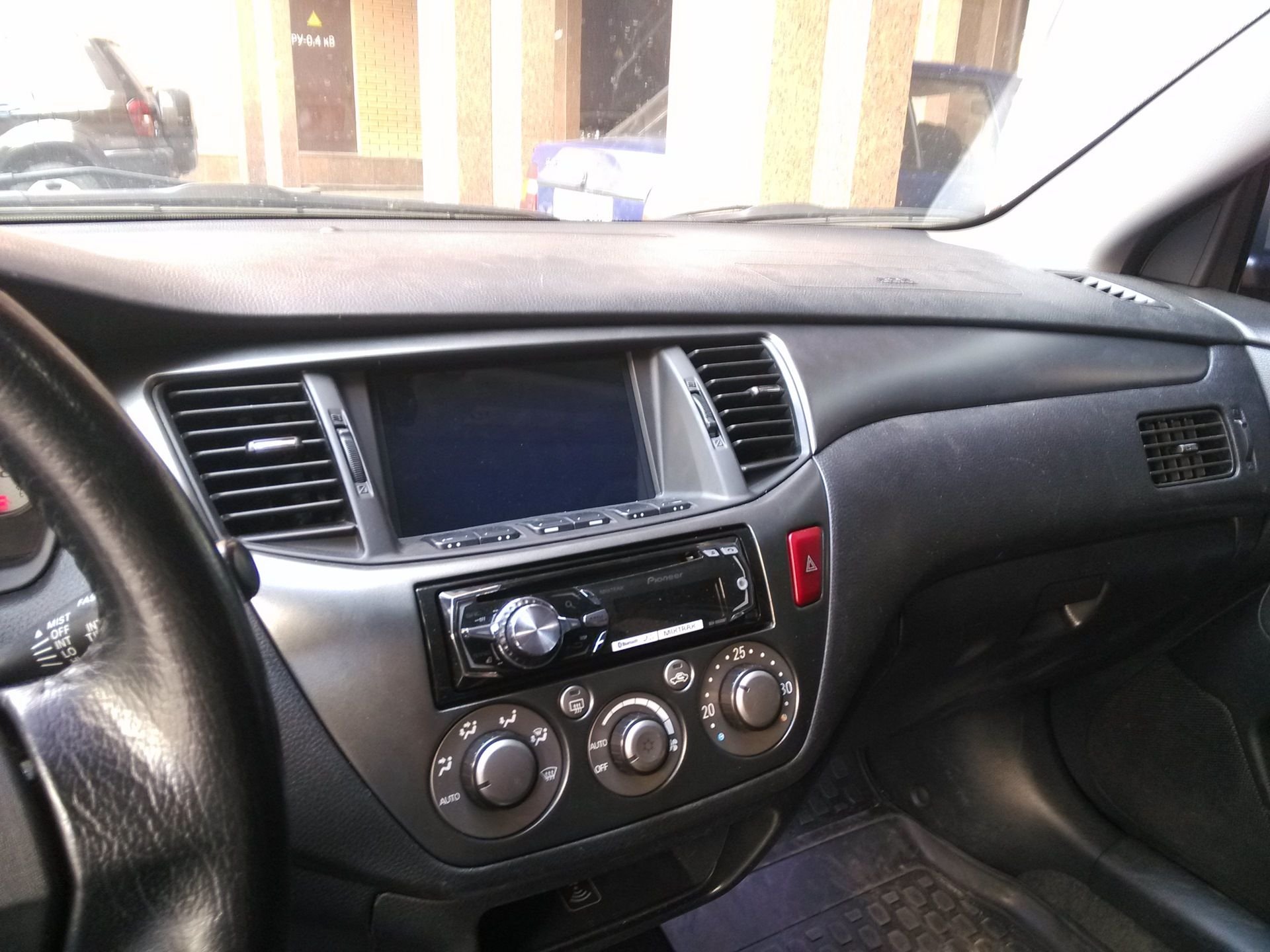

Hi! Everyone!
I want up this topic and say: "Yes! It is possible!"
I have succesfuly done with this on my MMC Lancer 9.
First of all I want to say that there are two ways to get this done. First - rebuild the RHD panel from Japanese Lancer, the second - find the original LHD panel from Mitsubishi Virage.
I did this in the first way. Also I have installed the automacit climat control (but this is the other story )
That's how it looks for me:
I did this few years ago. Because I was not able to find the original LHD panel. But now I have few original LHD panels! And going to sell them on the eBay.
So if someone still interested in this panels, here is my listing:
https://www.ebay.com/itm/OEM-MItsubi...m/162827194505
Also feel free to ask me any question. I'm done with hard work of investigation the MMC Lancer models for the different countries and now I'm a real guru of this panels
