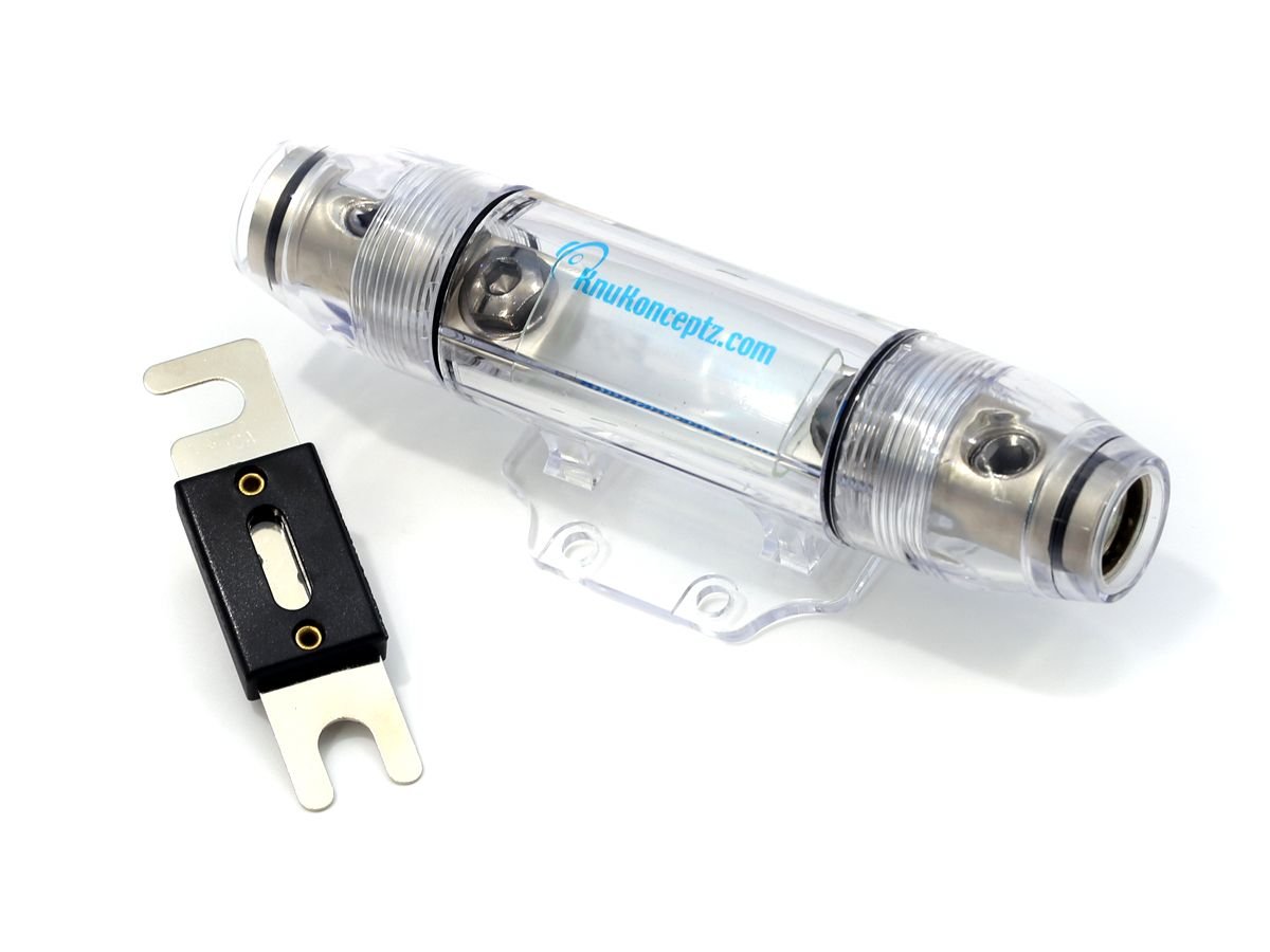

Perfect. Thank you! Here's the next question, run an inline ANL fuse of 150 or greater or run the circuit breaker?

I have a fuse on mine, but I can't see any issues with running a breaker. The circuit breaker has the added bonus of being a local disconnect for the battery so if you're working on the car, you just have to flip the switch instead of taking the time to disconnect the terminals.

What amperage fuse are you running? Just in an ANL fuse holder as well, right?

I'm using a 150amp fuse. JL audio ANL fuse holder.
