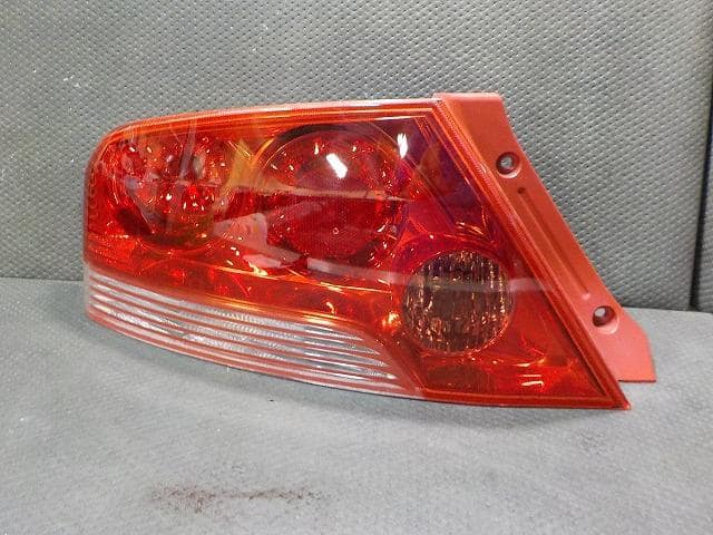

Q1: If those are off an Evo 7 that would be from the GTA variant, like so:

Added what reference photos I could find to my previous post. For the pedantic, even though there appears to be only a few common designs per generation of the CT9A platform there are part number changes as well as specific part numbers for different markets, likely driven by local vehicle engineering requirements:
Broad categories:
Evolution VII: Red covers over red lenses set in red buckets, EUDM cars depending on LHD/RHD get the reverse lamp on one side replaced with a fog lamp. Indicators are clear. There are no USDM cars for this generation.
Evolution VII GTA: Clear covers over red lenses set in chrome buckets, indicators are clear. JDM only.
Evolution VIII: Similar to VII GTA, however covers for indicators are now orange. USDM resemble the GTA buckets but lack line detailing over the indicators as pointed out above. EUDM cars depending on LHD/RHD get the reverse lamp on one side replaced with a fog lamp.
Evolution VIII MR: Clear covers over red lenses set in matte black buckets, covers for indicators are now orange. I don't think USDM got this specification(?). EUDM cars depending on LHD/RHD get the reverse lamp on one side replaced with a fog lamp.
Evolution IX: Clear covers over red lenses set in chrome black buckets, covers for indicators are now orange. EUDM cars depending on LHD/RHD get the reverse lamp on one side replaced with a fog lamp. USDM cars have clear indicator covers.
For the OP, your collection is pretty comprehensive except that you're lacking the EUDM RHD/LHD fog lamp versions of each generation.
