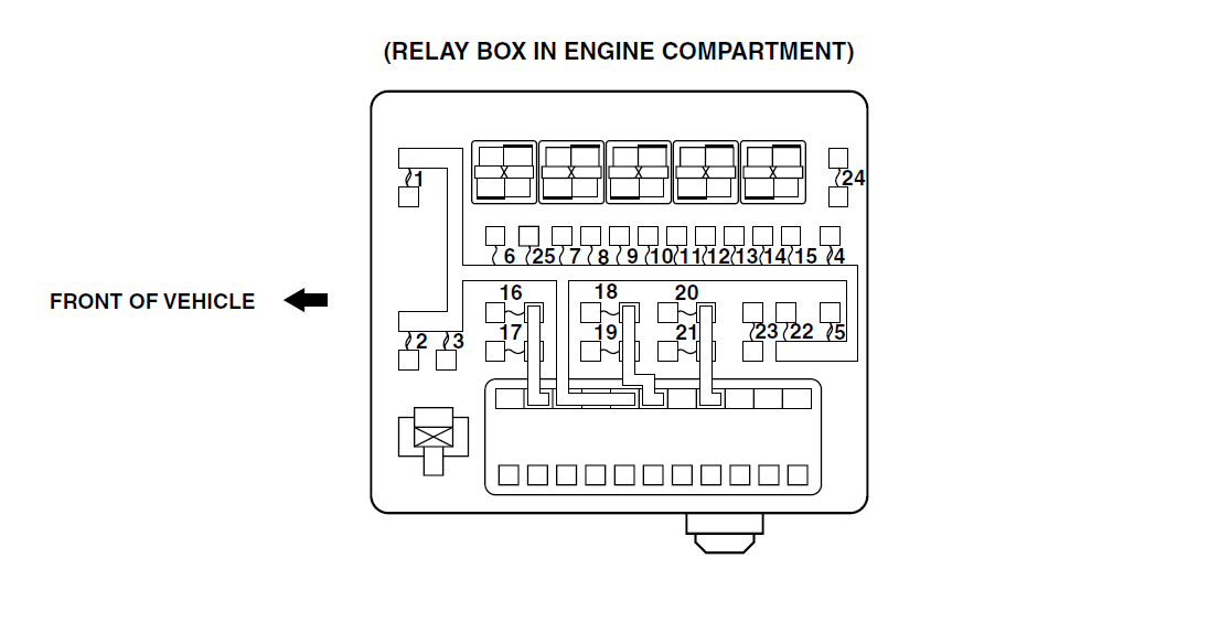

It sounds like you shorted something out in the LH side lighting circuit, maybe when replacing the rear bulb. The left side lighting is on fuse no. 21 in the relay box in the engine compartment.
Check fuse 21 - it is a brown 7.5 A. If it is blown find the short circuit then replace it.
