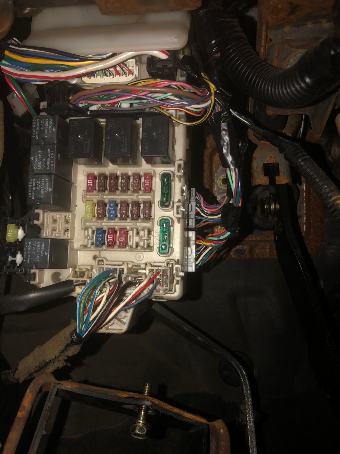

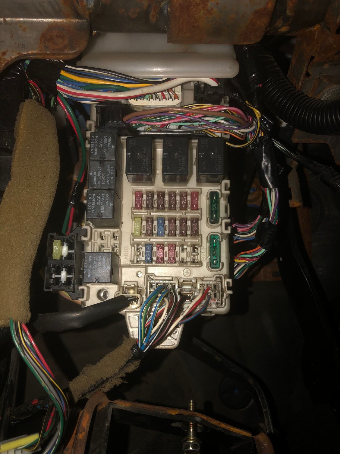

Hello
lancer evo 8 2004 jdm
Are the remotes learning into the BCM module, and this module transfer the electric/signals to the door lock when i push the remote? Or there is an alone module for the remote control? (Its oem remote ,not aftermarket)
Can someone help me in that which are those cables out of the BCM module directly whiches transport the electric to central lock motors?
I programmed a remote and it working backward, if i lock its unlocking, if i unlocking on remote the car is locking. So i want to check the cables and maybe somehow change the direction. But if anyone has idea for the problem repair feel free to comment it.
I attached photos about the module.

sorry i didnt solve the problem. i have no idea whats wrong.
my car was rhd to lhd converted , the oem ecu was changed to an ecumaster black, i dont know the BCM module or the locks in the doors was changed or not ,so the whole system is complicated.
Finally I installed an aftermarket remote entry system in the car and using that.
but still curious about ,because the original system is better so if someone figure out the problem, i will use the oem.

btw the backward working is solved, i bought other type of remote and that stabilized the backward working thing. so it now lock with lock button and unlock with unlock button.
BUT. after i lock the car with the remote, the car automatically unlocking after a ~20 secs.
some cars have a safety function if you unlock the car with remote but phisically u dont open the door the car locking back after a few secs. Thats working me backwards now. I lock the car and its unlocking after a secs. So when i locking, the car's "brain" realizing that i unlocked , and after a secs it do the oposite reaction "locking back" but now its not locking back , its unlocking back.
