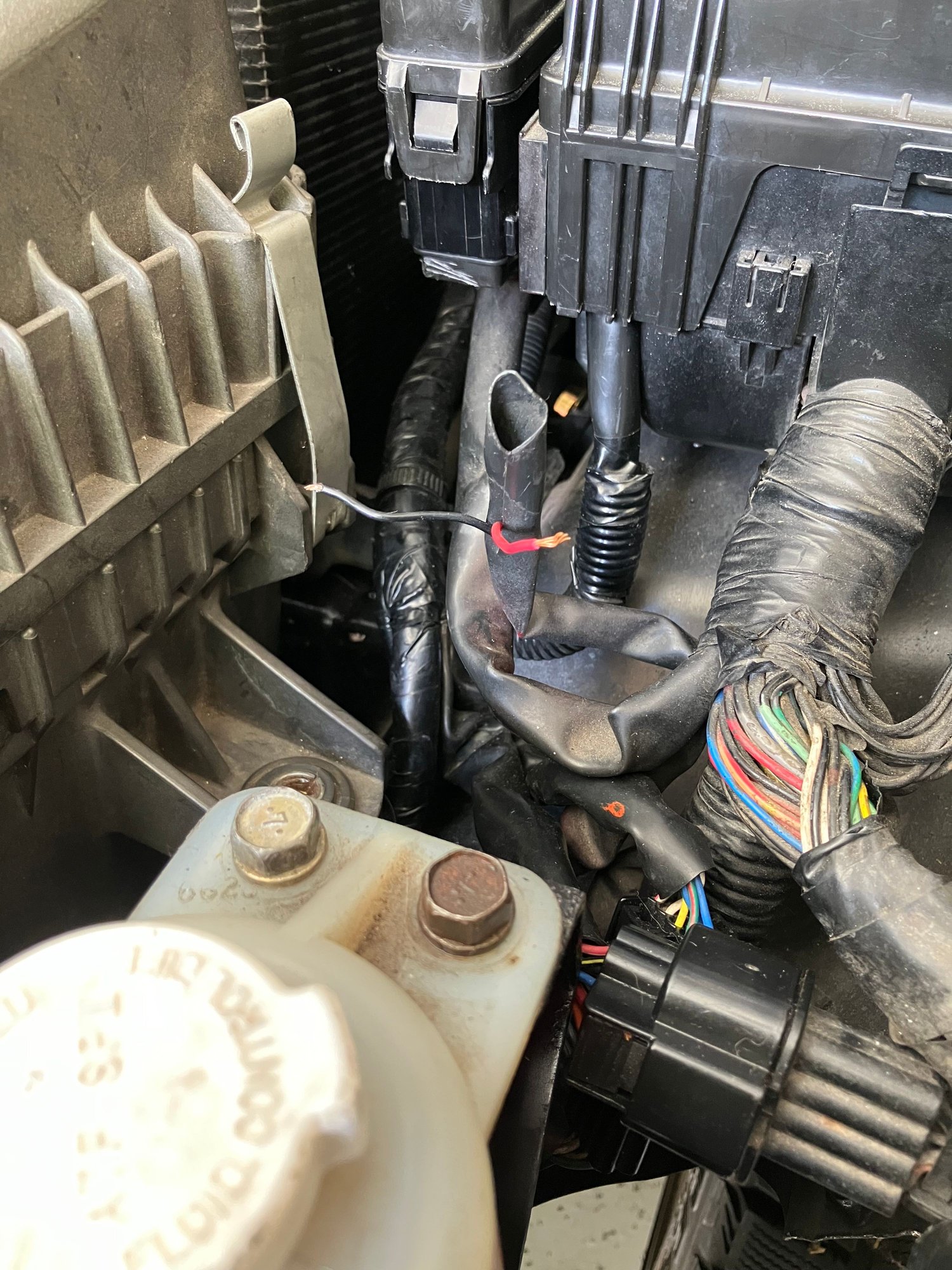

I'm restoring an Evo IX and the centralized junction/relay box has a pair of black/red wires that are cut, see picture below.
It has it's own insulation sleeve dedicated to these two wires, black has continuity to chassis ground. I tried finding continuity with the red wire to all the fuses but did not find any.
Anyone know?

The colors aren't right but the front LH (usdm driver side) impact sensor wires branch off right near there. It's a 2-wire sensor and the sheathing is taped to the side of the main harness until it gets close to the front of the car, where it splits and connects up to the impact sensor.
