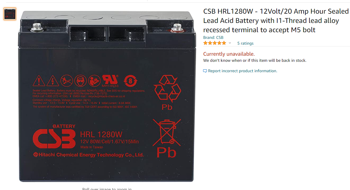

  • Been running the mini-battery setup for over 12 years. Have used only the Odyssey PC680 w/good results. They have lasted 4 years or so until now

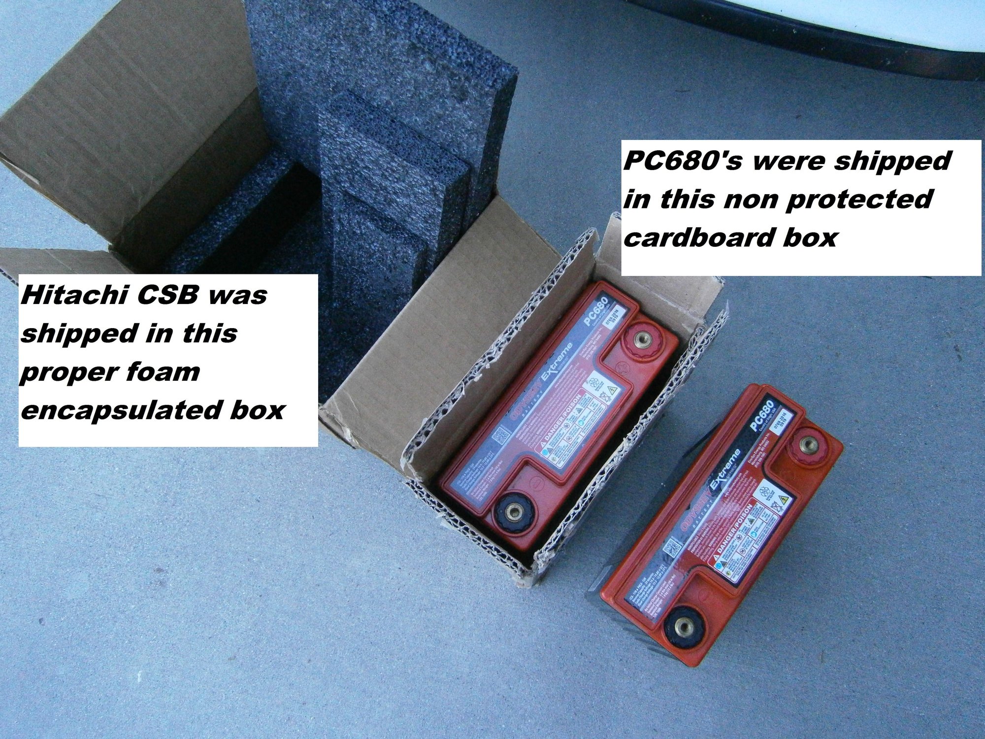

  • 1 month ago ordered, from Amazon, a replacement for a 4 year old PC680. Received & installed the 680. The battery lasted less than 2 weeks. Actually failed on the Battery Tender, topping it off.
  • The Tender had the dreaded alternating lights flashing indicating a potential battery failure.
  • Immediately contacted Amazon & received a prompt refund.
  • Long story short, the replacement 680 failed in the same exact fashion. Performed a parasitic load test & on all my 3 cars (including the EvO) showing approx 120 milliamps which is out of range but all 3 cars are the same. Dont think my EvO drained the PC680 as they both failed on the tender
  • Both failed PC680 have a remaining voltage of 6.74 & 5.65 (they are toast)
  • My theory is shipping damage to the PC680's as the shipping box was not protected vs the Hitachi which came in a proper box
  • So far this Hitachi CSB HRL1280W / mini Battery has been in the EvO for over 2 weeks & all is well.
  • Note: Although the main case of the CSB & the PC are the same size, the top cap on the CSB is just a bit wider in which i had to flip my top alum cap upside down to make it work
  • Also, the female threads on the PC are an M6 vs the CSB being a M5 so the upper terminals will not transfer
Will never order another Odyssey PC680 again
Hope this helps one of you guys

The Hitachi CSB HRL1280W has been in my EvO for a year now & works like a champ. I do keep it on the tender as the EvO only gets driven rarely. I think your 500W radio is fine. Just dont run it too long w/out the engine running

Yeah, the form factor is the same. Same size & fits in my tray (Nisei tray). The female terminals are M5 vs M6 on the Odessey so you will have to account for that change.
I ordered the following below but now shows unavailable on Amazon, but searching the model spec: Hitachi CSB HRL1280W (it shows availability & seems like the same parameters (double check that!)
