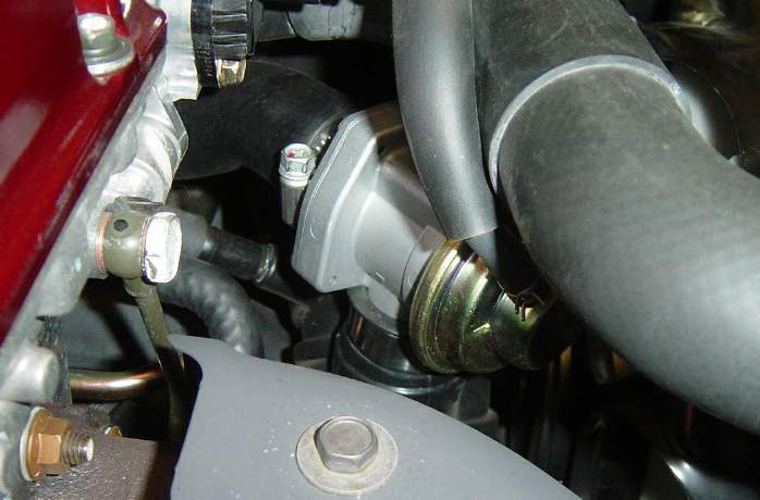

Got my evo mr bov today...installed!! Spring is stiff as hell! I'm running 21.5 lbs boost with a turbosmart e-boost...at blow off, it flutters so damn hard. never a clean blow off..just a hard flutter. But damn, holds boost NICE! AND BETWEEN QUICK SHIFTS, HOLDS THE SPOOL TO A t..VERY NICE...BUT THE ONLY THING IS ITS A LOUD FLUTTER BLOW OFF. Will the spring give a bit? NYONE ELSE WITH THIS PROBLEM?

is it on backwards?

nope, round part on top with nipple.

The top of the BOV is not supposed to be on top. It's supposed to be on the side when mounted.

Here's a picture of it mounted:

ahahahahahah, oooops!!!!
not hurting anything right? ill fix it in the morning

Nah, it shouldn't hurt anything since you just installed it.

told ya....

ok, i just went outside and fixed it. test drove..and niiiiice
