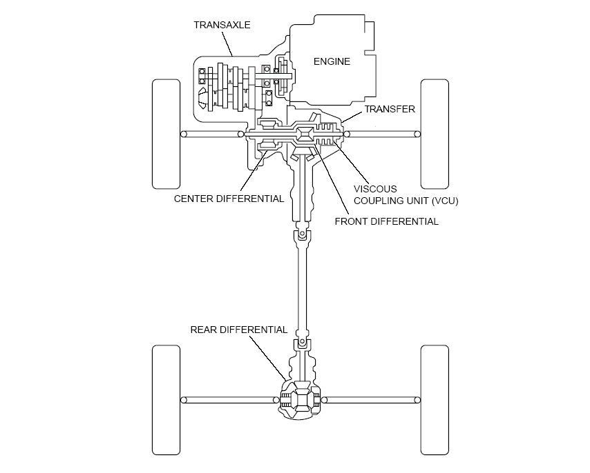

STOP WITH THE MISINFORMATION, PLEASE!
The front differential is in the transfer case. The transfer case is NOT inside the transmission. It sits behind the transmission and is sealed off, for all intensive purposes. Why do you think the transfer case and the transmission take different types of gear oils? If fluid from the transfer case can't make it to your transmission and touch your synchros, I seriously doubt pieces of your front differential could either.
If that pic you posted destroyed synchros, then it must have been a center differential, not a front differential. In fact, that looks like a stock 2 side gear center diff out of a DSM.
Center diffs were known to grenade like that on the DSM's. I've actually done it before.
