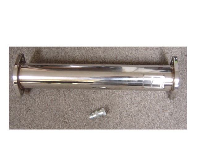

i finally got my test pipe in. i bought it off another member in the classifieds thread. this is what i got. now how the hell does this "cell fix bolt" suppose to work? theres no 02 bung!!!!

The O2 bung is AFTER the cat, not stuck into the cat.

so where do i connect the cel fix bolt? and what do i connect it to?

Remove the O2 sensor from the cat back (the pipe behind the cat) and screw it in there, then scre the O2 sensor into the spark plug anti-foul thingies.

yeah what /\ he said your gonna need a good sized monkey wrench most likly to get out ur 02 sensor its after your car in the cat back twist it out and ur most likly gonna have to pull the rubber gromet out of the bottom of the car a bit to make it so it will twist inand not twist the wires or twist them in the opposite direction of how they screw in.
