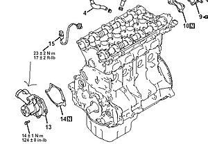

Does it look like this. Or one of the four circle things on each cylinder.

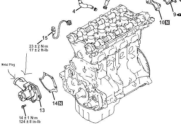

Ok, I see where it is. There should be a plug (metal plug) right there but it blew off. You need to get that sealed again or goto dealership.
