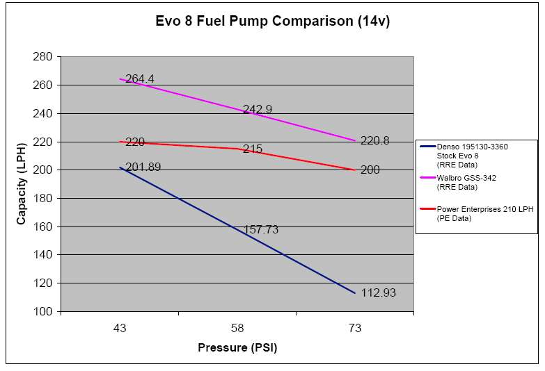

freedom's Avatar
Posts: 755
Ask and you shall receive....
Mine is still running with zero issues / noise and it has been in the tank longer than yours. It's worth the price.
Originally Posted by Zeus
I've posted elsewhere, and don't have the time right now to go into grand detail, but I LOVE my 210lph Power Enterprise pump (drop in less the plug like the SARD). It is a Denso unit that is utterly inaudible. Deathly quiet. The flow charts are posted somewhere here and look good. I'm told their larger pump is just a Walbro though... the only downside to the 210 is the price... a good two bills. I've not gotten time to pull it back out and get the Denso part number to try and source them directly (was in a hurry). After killing two Walbros in my Evo, I'm quite happy with this unit.
PS to reiterate, I DO NOT SELL THESE (at this time )
Attached Thumbnails Walboro ONLY OPTION?-fuelpumpcomparison.jpg   Walboro ONLY OPTION?-pe210_fuel_pump.jpg

Latest HyperRev lists the following fuel pumps...
- SARD @ 235 or 265 litre / hour
- HKS Kansai Service @ no flow rate listed
- Deck Mechanical Power @ 260 litre / hour
- Power Enterprise @ 210 or 255 litre / hour
- St Sport @ 255 litre / hour
- YR-Advance @ 230 or 265 litre / hour
I'm guessing that most, if not all, of these Japanese fuel pumps are made by Denso... but that's just a guess.
