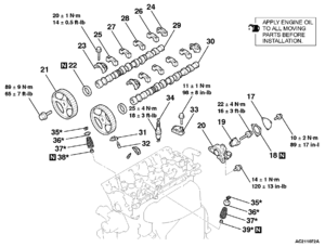

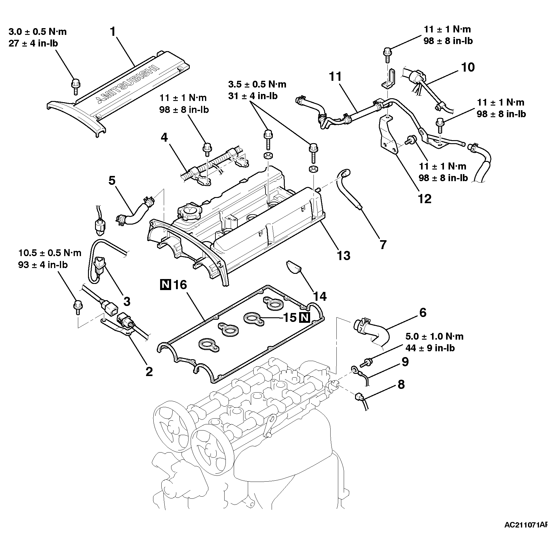

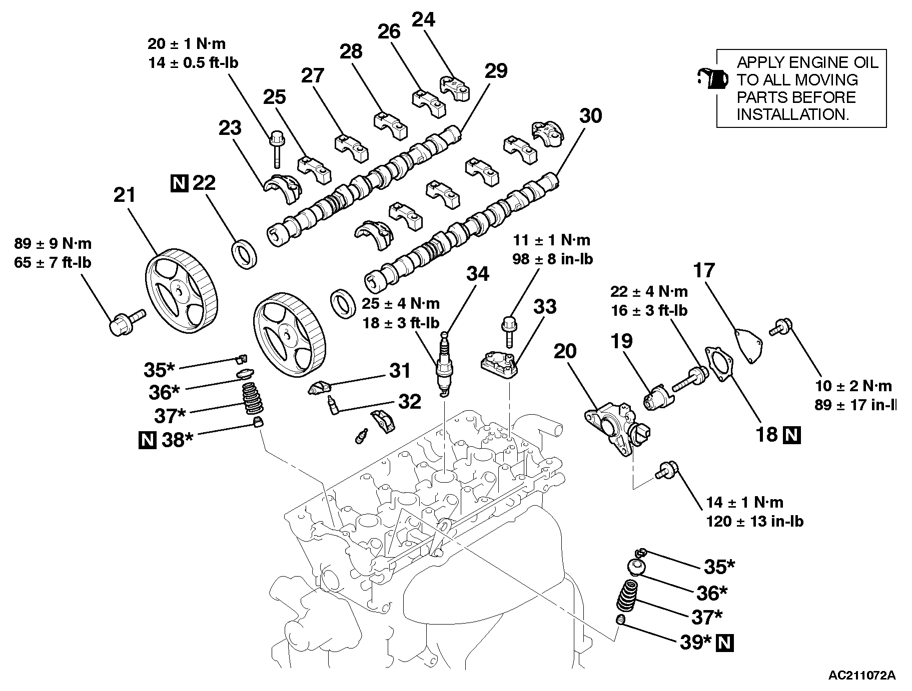

Check out these pictures, they are schematics of the stock valve cover and Cams should include all of the torque specs. They are from the Mitsu OEM service manual. By the way I would highly recommend picking one up. Sell on Ebay for like 10 bucks, its worth it, can be a pretty good ref.

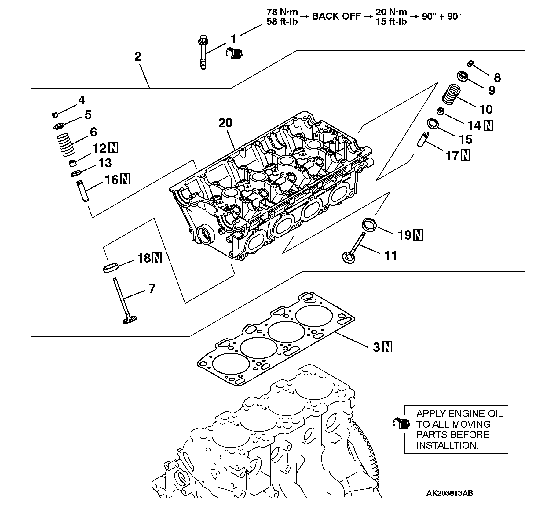

Forgot one. just in case.
