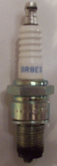

I just noticed that the tips on the OEM iridium plugs are protruded more than the ones on the NGK BR8ES. Could it be that the the BPR8ES is needed in higher horsepower applications? Anybody had any problems with the regular BR8ES plugs?
I used the BPR8ES for one year before my last tune and they worked great. Sorry to hear about all your issues Seth. I cant believe that gas can be that bad in your area. Try to fill up with 89 gas. I know that sounds weird or dumb but if the problem is more severe with 89 than you know its 100% gas related. FWIW you should not see knock on lower gas octane as the stock ECU must react fast enough to pull timing and add fuel. I am not sure if I am 100 % right at that point but from what you are saying the knock is lasting for a bit of time and you clearly can hear it.
