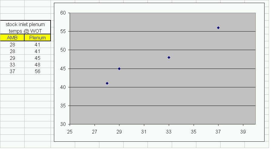

Old May 16, 2005 | 03:18 PM
Aby@MIL.SPEC's Avatar
iTrader: (161)
Posts: 3,043
Likes: 13
From: San Elijo Hills, Ca.
Interesting findings......
This is what I measured. If you follow the trend line, your inlet temps were much warmer than mine, however I didnt test in as cool conditions as you did.
I have a stock ic system & air box, tested in warmer conditions, used an exposed junction t.c. within the plenum.
I wish more people would post thei results / findings,
