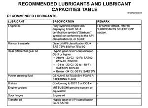

Isnt the 75W90 for the center diff?
Old May 18, 2005 | 02:57 PM
ride22's Avatar
Posts: 230
From: IN
Here you go
