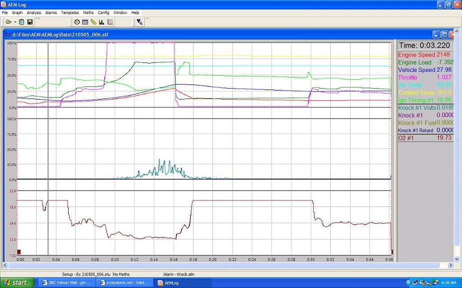

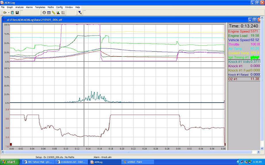

Ok here is a 3rd gear pull I just made. The first image will show temps at 98.69 degress intake temp. The next image in boost will show 93.20 in 3rd gear at 5371rpm. The pull goes up to about 95 degress at the end or so but that is it. The temp was 85+ degress.
After look at where you live it could have some affect on what you are seeing too so I honestly can't speak for that since I live in missouri. Humidity is high though, today was proably 80-90% if I had to guess.
Attached Thumbnails Inlet temp-airtemp-normal.jpg   Inlet temp-airtemp-boost.jpg
