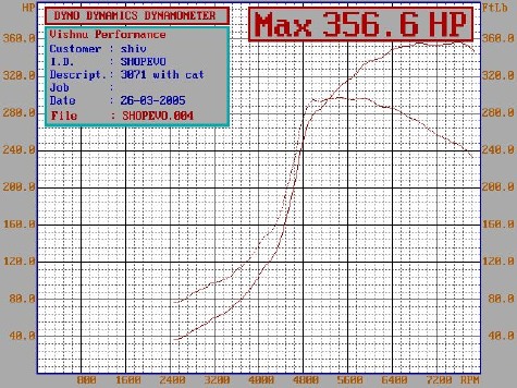

Nearly 400 ft-lbs at 3500 RPM, with only 300 HP at 5500 RPM?
Look at the attached dyno sheet from a customer of Vishnu, the car is making about 320 HP at 5600 RPM, but less than 120 ft-lbs at 3500 RPM.
Anyone have any ideas what they do to make torque so early in the RPM range?
Attached Thumbnails How does the WRC 05 develop so much torque?-shopevo1.jpg

Just out of curiosity, is there any Evo on this board that is making 400 ft-lbs of torque by 3500 RPM?
Tuners obviously aren't building motors that will comply with FIA rules, so all modifications are free. So if a big turbo with a lot of boost is the answer, it would interesting to see if Dynoflash or AMS are making in the neighborhood of 400 ft-lbs of torque at 3500 RPM.
