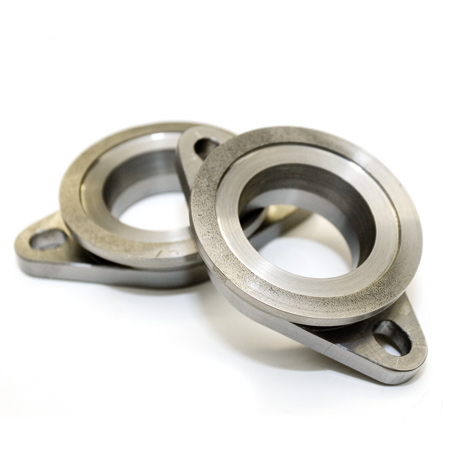

Originally Posted by propellerhead
Maybe time to bump up to the 44mm WG?
Keith
PS: Wouldn't I need to bore out the hole in the manifold larger to match the wastegate then?
