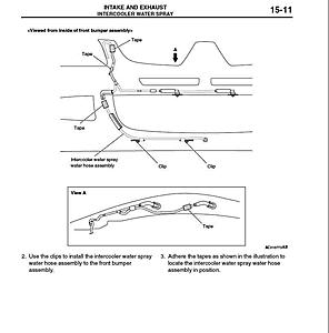

When I boughty my 2003 evo, the lower intercooler sprayer hose and nozzle was missing. I bought the lower hose and both nozzles. I can't for the life of me find out where to mount them. Right now they're zip tied to the front grill. Does anyone have a pic or a diagram of the mounting location?
Hope this helps.
Attached Thumbnails Where do I mount the intercooler sprayer nozzle-int.-spray1.jpg   Where do I mount the intercooler sprayer nozzle-int-spray2.jpg   Where do I mount the intercooler sprayer nozzle-int-spray3.jpg   Where do I mount the intercooler sprayer nozzle-int-spray4.jpg

I understand this is an old thread but I feel completing this one would be better than starting a new one. Ho k, my car had no IC sprayer nozzles when I bought it. I just ordered a set of used ones from a fellow evom-er and I'm a wee bit confused. The part that I got has the mounting circumference a little bigger than a penny, give or take, with the holes in the front bumper are closer to quarter size, the "coin sizes" maybe off but all thats important are that the nozzles fall through the holes in the bumper. What am I missing?

From what I've read on the forum windshield washer fluid is the best option, and that regardless of what you put into it, it does little if any good. This is simply about having all parts of my car functional, can someone post up close up pictures of where and how their sprayer nozzles are mounted?
