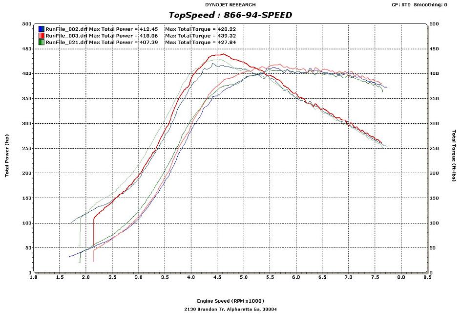

Thats on a Dynojet with STD correction. That always give a high reading. Change that to SAE and it will be just under 400whp.

nice numbers.. really impressive......

Looks good, hopefully I will have some information to post up here in less than 2 months...
