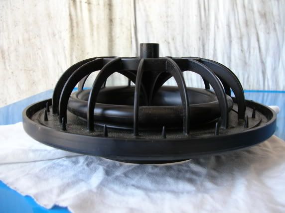

I have tuned this intake aswell and they are a horrible knock off. I also would advise to stay away from them and buy a quality product such as the hks.
Along with the fact that the maf adapter leaks the othe main problem with this kit is the actual filter element and filter housing.
The HKS intake is designed to smooth out the airflow before the maf allowing for a proper reading, while this knock lacks that.
Atached is a picture of the HKS filter housing with the foam element removed, you can see how much design goes into building a quality product, such as this one. Also notice how the hks filter smooths out the airflow before the maf using vanes and a smooth transition.
Doug
Yep, HKS knock off my butt. The filter is a huge problem, but I agree the whole thing is garbage. I tried one of these out (not from Ebay) and it lost a ton of power. I bet it was 50whp or more. Didn't need the dyno to verify that. It also lost a ton of boost. Pure garbage.
