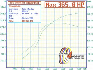

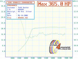

GT3076R PeakBoost kit DD Dyno#'s
the guys at Dyno4mance did a great job on this one.
awesome pump gas #'s with a killer powerband!
BOOST/AFR plot
AWHP/TQ
365awhp on the DynoDynamics, way to go Todd, Andrew, and Chris

heres as far as i know, im sure todd has a full break down. but, just a super simple setup, daily driven on pump gas.
-PeakBoost GT3076R kit
-Autronic
-280 cams
-3" exhaust

93 octane
cam gears
twin disk clutch
the car spools much faster on the street.

still building hp after 7k thats good

Good numbers but you could come in a little leaner on it and make some more power with even better spoolup. Great results though not knocking anything so don't take it the wrong way.

Good numbers for a fairly simple setup. Good powerband.

what psi is this? also, any idea what alky injection and 26+psi(not sure how high you can go with pump and alky) would make?

dont want to run alky, no need to and it was at 21 psi, I am sure in a few weeks I will put it back on the dyno to work on the af a little but the car is a blast to drive.

What is the size of the back housing on that turbo? Seems a little low to me for an upgraded turbo.
