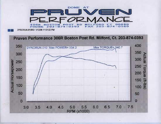

I go through all this trouble and you only look at PEAK POWER. Warrtalon was the only one to really disipher these graphs.
Let me break it down for you -
Why do you think I posted the EVO IX no mods v. EVO IX with mods? The whole point was to show that peak torque only change by +7lbs while peak hp increased by +30hp. No big torque gain right?
WRONG
Now if you REALLY LOOK at that graph - notice WHAT THE 272 CAM does do - and that's fatten up the mid range. Look at how my modded IX holds the torque past 5K rpm - while the non-modded IX torque drops off. This is where the 272 Cam shines. NOT in peak numbers - but in midrange.
On the road course - I need midrange. Not peak power.
Now - another exercise. Look at the 100ct map. Notice how much the torque drops off from peak?
Can anyone - besides Warrtalon explain why this is happening?

Your IX holds torque past 5K rpms without the flash, but with the Flash and 100oct torque begins to fall off before 4.5K rpms, which is just about where the tq begins to fall off on a IX that dynoed 100oct and no Cam, and infact I believe it has a flatter TQ curve. Sorry I hate being the pessimist, but I'm not really seeing any benefit of the Cam.

I'm sorry, but I think I'm not really following. I shouldn't look at peak whp numbers? What else do I have to go off of? Your comparing the graphs of your IX with no mods to the one with mods and saying look at the difference, well no sh*t, of course there would be a difference. But the question I want answered is how would this compare to a IX with the same mods but no Cam? I can't make much of a comparison because there was never a dyno done comparing the the IX with Cam and with out, and so really all I have to go off is peak horsepower! The peak numbers you made are no different than what a IX with out Cam would make, maybe even less.
Your IX holds torque past 5K rpms without the flash, but with the Flash and 100oct torque begins to fall off before 4.5K rpms, which is just about where the tq begins to fall of on a IX that dynoed 100oct and no Cams, and infact I believe it has a flatter TQ curve. Sorry I hate being the pessimist, but I'm not really seeing any benefit of the Cam.

IF you had any insight into the IX's - you would already be well aware, the IX's make very little power with an exhaust and an intake compared to a bone-stock IX.
Ask Shiv - the difference on the dyno is next to nothing for those mods. Zero to +5. So - adding the cam, adding the mid range. Plan and simple.

Never said I wasn't impressed with your numbers, as I said before I have been very impressed with the IX for awhile and your numbers are nothing new. But maybe I was wrong, but I thought the main focus of this thread was to see what an EVO IX can do with the Cam, not just what your numbers would be after mods and tune. I know that the IX will put out very impressive numbers with mods and tune, but what I was anticipating in seeing was the difference a Cam would make, because I too was interested in doing the same thing to my IX when I purchase it in the near future.
I appreciate you having the ***** to be the test subject for the Exhaust Cam, you probably saved many IX owners and future IX owners money. For that I thank you very much.
Just so we are clear-
1) Your numbers are damn impressive, as are most IXs with the same mods, no doubt on that. Congrats on a very powerful car.
2) Despite the impressive gains from the other mods, I see little to no difference with the VIII Cam on an EVO IX vs. No VIII Cam on an EVO IX.

Has anyone checked the duration numbers of the stock cam versus the 272, and I am not talking advertised duration. I mean hard numbers like ramp rate, and duration at .050 lift?

Joe, I see the extra power/torque after 5k on that one graph, but I have no idea what the difference is between those 2 graphs. The way it's worded is the first run (270/270) was completely stock and the second run was with all those mods added at once untuned (300/270). I don't see that as the cam doing anything. I see that as the exhaust releasing some top-end power that was being robbed. Perhaps you mis-labeled all the graphs and didn't properly indicate exactly what mods were present during each pull?
Also, notice there is no mention of any type of boost control, yet the 2nd graph with the tune says 21psi (requires some sort of boost control, and it doesn't appear you were at 21psi on the earlier graphs, because of the lack of torque), then you have 26psi on the 100oct graph. Do you have an MBC/EBC or what? The reason why some IXs don't make as much power with I/E at first is because of no boost control - the ECU lowers it to account for the additional airflow - but that wouldn't be possible if you already had a boost controller set at 21psi...

OK...Here is your graph with your mods on your IX with TBE, Boost Control, Intake and HKS 272 exh cam and Flash at 21psi...
Here is a graph from a similar IX with no cam..just Buschur TBE, MBC and Flash at 20psi
I'm not really seeing where the cam makes a difference

Yet, at our local Dyno Day last Sunday, we had 3 stock IXs put down 244-254 whp on a Dynojet, then had one with TBE/MBC do 285whp and another with TBE/MBC/Intake do 300whp.
