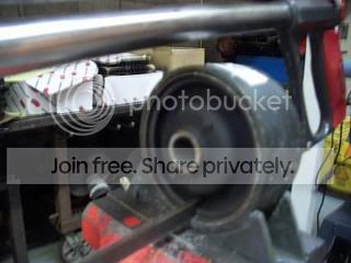

Got my front one done yesterday @Works along w/cams, TB. I LIKE the vibrations at idle(combined w/cam lump)... Your EVO will feel like a street bike after the bushing. Vibes through the seat, shifter & steering wheel. Another thing I will add is part throttle tip in is WAY more sensitive at top of 1,2,3rd gears since motor is more 'connected' to chassis so car responds quickly(jumps) to throttle input. Reverse bucking is almost gone! Imo - Car has more character. Car is factory smooth once it rolls and droning at freeway speeds. ONLY vibes while stopped. Its cool to come to a stop after a commute at a redlight and feel car vibing along w/the cams. My opinion comes from owning street bikes & an I-6 AMG Benzo on liquid filled mounts. (BTW - 1-2 hr job) for you driveway warriors
Martin @Works cutting out the jelly mount....That center sleeve is totally moveable by hand allowing engine/trans to lash. . .alot of why the driveline is so hard to modulate

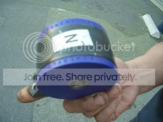

Also, the bushing pictured in post #58. I am not knocking it but I want to point something out. We were going to make our bushings like that too, it was a little cheaper, they would have had flat sides and been the same thickness down to the center steel bushing. I didn't personally like that look and the factory mount isn't shaped like that. I went ahead and had them machine them shaped like the factory mount and ours gets progressively wider until it is the width of the steel bushing, like the factory was.

I don't see how flat sides and imprinted company logo with ss insert of greater thickness could be a cheaper design.
In our opinion, the flat sides give the unit a better fit and makes it snug against the black bracket in the picture which we believe to be a benefit and superior design.
