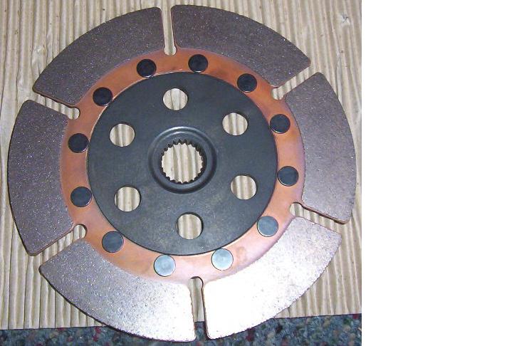

Here are some pictures of the new disks. Amazing how thin the friction material is.... but in reality it is three times as thick if you think about it from the right perspective isn't it?
Keith

As long as the disks wear evenly, then yeah, you've got the right idea...
