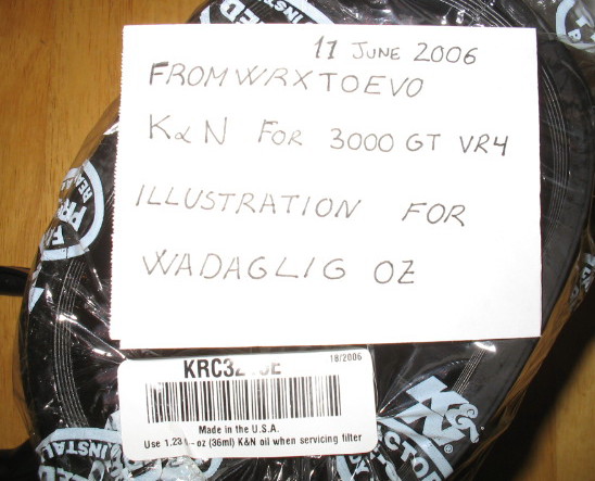

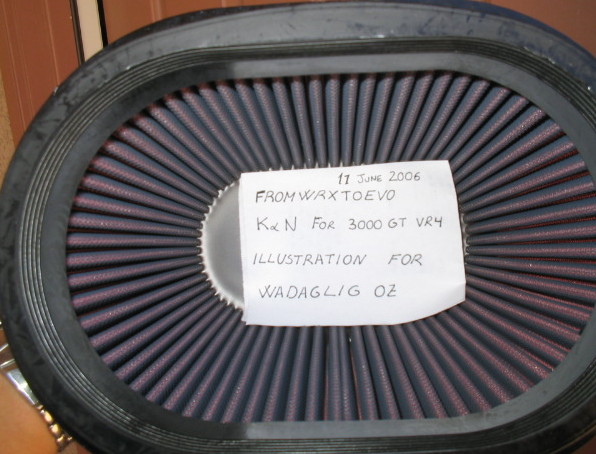

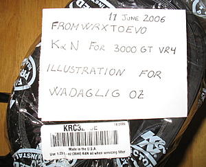

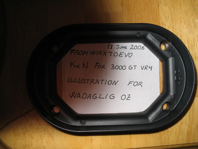

The main issue here is that the air intake inlet on the second gen DSM and the 3000 GT are oval to start with. The Evo air intake/MAF shape is different
I do have a Stealth R/T and I happen to have the oval air filter on it. The issue is not the filter itself, the issue is that the MAF is not shape the same way(oval) as the 3000 GT or 2nd gen.
Give me a few seconds and I will take a pic of the stuff for you.
Carlos
Attached Thumbnails New intake question-img_0015.jpg   New intake question-img_0012.jpg   New intake question-img_0018.jpg
