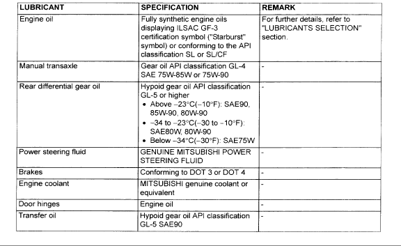

stock fluids help please

hope this helps ya
Rear Differential
Hypoid gear oil API classification GL-5 or higher SAE viscosity
- Above -23°C (-10°F): SAE 90, 85W-90, 80W-90
- From -34°C to -23°C (-30 to -10°F): SAE 80W, 80W-90
- Below -34°C (-30°F): SAE 75W
__________________________________
Transfer Case Oil
Hypoid gear oil API classification GL-5 SAE 90W
_______________________________________
Transaxle oil Gear oil SAE 75W-90Wor75W-85W conforming to API classification GL-4
Originally Posted by evodan2004
i was seaching around and all i seem to find is what to put in trans, tcase and rear diff. i dont want to put anything other then stock back in. im going to the dealer today to pick up a few things plus this. so my quetion is what is the stock fluids in the trans, tcase and rear diff. i own an 03 evo 8. thanks alot. i also may just go pick it up at the store if it is cheeper

Originally Posted by rcheung
I'll look at my diaqueen can when I get home and Ill get you the part number. I have an 03 evo. As for the transmission fluid use the bg syncroshift for fwd transmissions. I bought mine here http://www.prostreetonline.com/buy/bg_synchroshift/
I guess your second thread already answered the question for the part number
https://www.evolutionm.net/forums/sh...hreadid=209580
