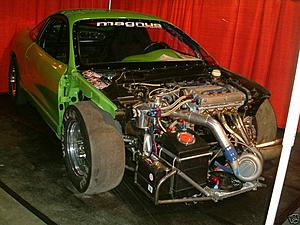

Magnus's Avatar
Joined: Oct 2006
Posts: 82
From: Toronto
T88h
We run that on our 2g FWD it's laggier than a 42 by about 500RPM but make great power.
