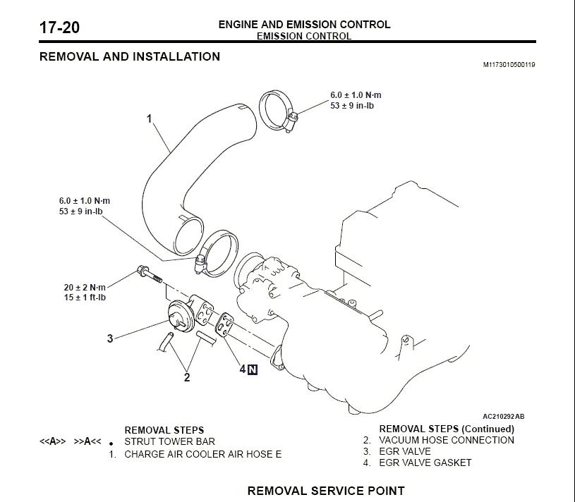

hey man, where in NC are you ? you can come down to fayetteville and we can help you the best we can.... we found a leak on my friends evo behind the throttle body on a vaccuum hose back there... you cant see it unless you are laying under the car and looking exactly where it is.... you can feel the hose i am talking about if you reach your hand behind the intake manifold near the fire wall and feel around for hoses... we and up fixing his car and it holds 27 lbs no problem, before that, we couldnt even build any pressure when leak testing. also, your pump probably will not pressurize the system enough to hit anything about 15 lbs... i have a 3 gallon tank and i can push it past 20 or so... it starts to be too much pressure for the tank to push in...

there are two vacum lines that are back behind the throttle body one points down wards the other to the side towards the passenger run your hand down the back of the intake manifold and you will feel what is almost like a coin and bellow that will be the vacum line and a little up and to the left should be the other one. . . i would check those as the guys before stated that is where the leak is most of the time

I think these guys are talking about the EGR vacuum lines. They shouldn't cause your boost to be that low. I think the answer lies in the BCS or the hose for it. but anyway, here is a picture of the vacuum hose I believe they are telling you to check.. this is from the 2005 Service Manual
what im referring to is where the yellow dots are... not sure which dot it is exactly but it is definitely not on that side where you pointed...but that could be another spot
