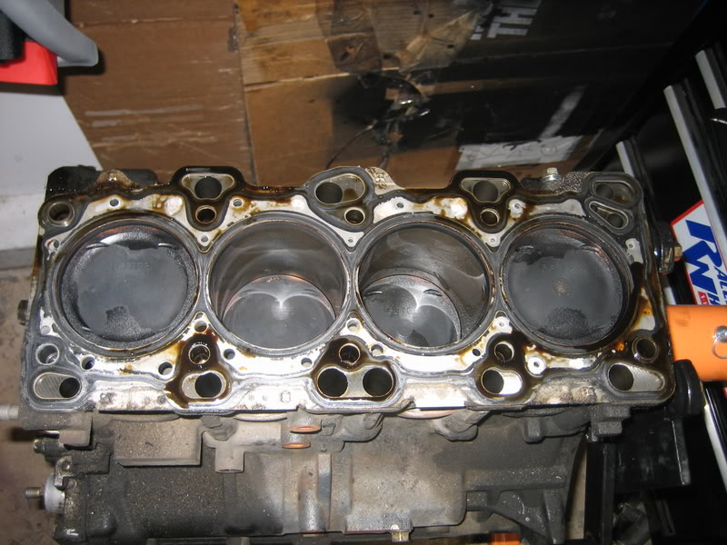

Here's what the leaks look like from the 1x1 method - they're everywhere. Into the cylinders and out onto the block.
