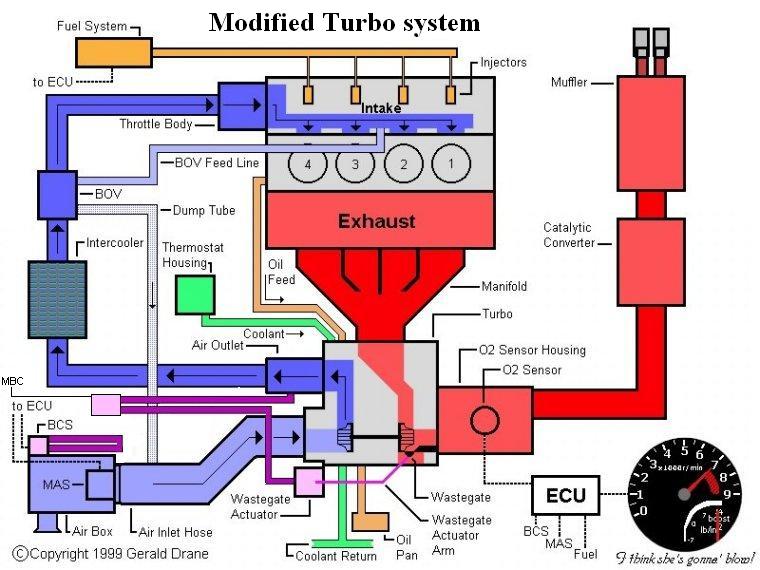

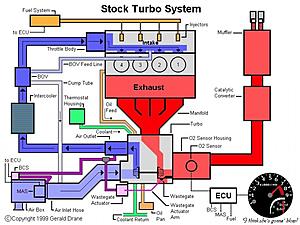

There should be something in the boost controler manual, but this is the jsut of how it should be hooked up. Rember to put the source and Actuator in the right lines.
images from GCG Turbochargers http://www.gcg.com.au/Technical%20Da...hnicaldata.htm

^ ok I am a little confused from your last post. But basically you need to find out which nipple on the MBC goes to the source and which goes to the actuator. Then you plug the hole on the bottom of your MAF pipe. And remove that whole t setup you have. And leave the Stock BCS plugged in but just run a short vacuum line in a u so both sides of the stock solenoid are connected to each other. Then Mount your MBC in the Area of the stock BCS. Leave it easily accessible, but make sure it isn't gonna flop around. Then Run the Source line to the Open nipple on the turbo, actually it should be a pipe directly connected to the turbo. And the Actuator line to the Wastegate actuator. set the Boost controler for stock boost, or completely open / no vent. Then make sure you have an accurate boost meter, and start turning it up until you are statisfied with your boost level. I would reccomend only runnling like 20 - 21 pounds on 91 octane.

Here follow this..
hope this helps you

^ sorry thats wrong.
What happens is when you let off the throtle the Wastegate will shut causing damage to the turbocharger.
