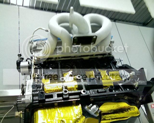

crappy cell phone pic, forgot the camera,
GOLD FOIL lol
more pics this week
cb
