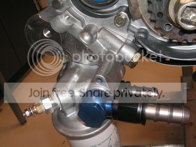

here are the pushlock oil cooler fittings..
cb
