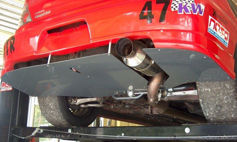

USDM EVO8 diffuser on our Time Attack car with the APR wide body kit.

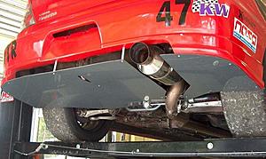

iunno how comfy you are with doin' body work dave, but i'd say you should cut that bumper at the "line" going all the way around (the one that goes across the license plate area) and move the diffuser "up a notch"

That would be a job and half. Actually I was thinking that since it is impossible to keep all the air out of that upper area it might benefit from leaving it open to let the air pass back out. Remember, it is only like that because of APR's wide body kit. On the USDM EVO8 it fits flat all the way around.
yeah i know it'll fit the 8 bumper, but i'd suggest cutting the 8 bumper too
and then for any flow that squeezes above the diff etc. you can poke some holds in the rear... mabe 3 on each side. this will give you a lotta df in the back without presenting cross sectional area to oncoming flow like giving your wing more angle would.

Likes: 32
The holes are so ugly!!! I am only willing to do so much and nothing at the cost of UGLY. haha
Fatheroftheevo, if you just want an undertray and not a splitter this material I am using would work great, you could fabricate those kick ups into the tire area if you felt the need.
