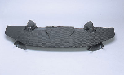

Originally Posted by JondemandSales
GarageHRS does not make a splitter. It is made by Voltes. called the SPL Dry Cabon Splitter. The voltex splitter is proven to be the best splitter in the world. Many of the hardcore Racers will use the Voltex one because it is 1. proven 2. the quality is so high 3.its easy to install and will not break. The Cyber edition front splitter is measured at 900lbs of downforce in the front. Just look at the pictures from GT Live in Virginia against ASM. The height of the water running from the rear tires.
who is this made by?
Attached Thumbnails downforce games-cwest-splitter.jpg   downforce games-cwest_up.jpg
Old May 14, 2007 | 06:37 PM
  #110
Blue By You Evo's Avatar
iTrader: (51)
Joined: May 2005
Posts: 627
From: Ocean City, MD
dont know about evo daves lip. doesnt look like garage HRS. but the second is the c-west front underpanel diffuser for their bumper.

i'm now realizing that those are indeed two seperate pieces... i recall asking evodave and i must have misinterpretted his response or we were both confused about what we were referring to.
to socalmr. you should get the cwest piece... but it's like major bank... or just get the voltex undertray and make it fit on the cwest unit... the voltex is only 500 bucks seperate.
