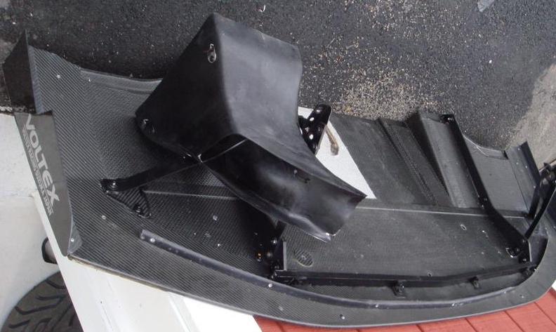

Voltex dry carbon splitter on Stillways evo
preserving pics for posterity
