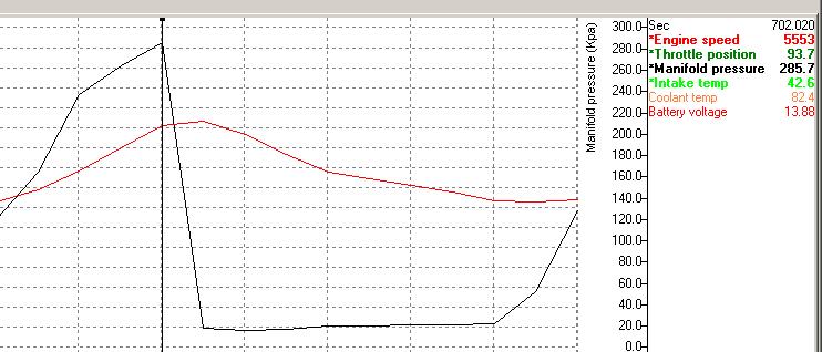

I think your right... but I would counter it is IMPOSSIBLE that at 40 psi you are only get an increase of 7F. It just sounds ridiculous to me. Here is a log I pulled from my car.
Ambient temps would have been about 22c. So intake temp at full boost was 42c. Net increase of 20c.

It is not impossible. Go take a look at the Nisei tests. On a one gear pull a good intercooler should barely go above ambient.
Eric

20 degree increase is rediculous,,, get a new intercooler!

I'm totally not out to prove anything or discredit anyone. I just spent a lot of money on a new longblock and I want everything to be right this time around. I have an honest interest in what intercoolers perform well.
I'm merely pointing out that it would be great to get a bit more info from David B.
And even better for people running different intercoolers to post some data of their own. Anyone running a speed density based ecu should have some logs they can check.
