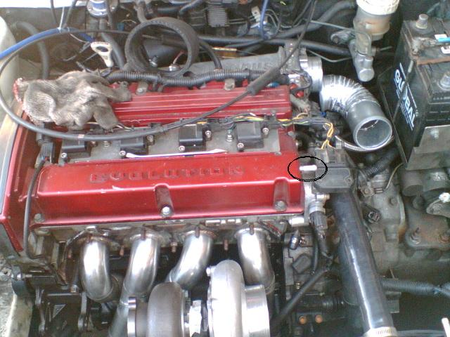

But i discovered that the guy who installed it capped of the breather with a plugg. Im talking about that one vacume line that runs to the intake on top. I think its the valve cover inlet.
so i was hoping that because the inlet was capped with a rubber plugg maybe it was a blow by.
what you guys think?
below is a pic off what im talking about. he capped what is circled

found out that its called the breather hose and its not good to plug or block it.
Like that link i have up above his breather hose was apparently blocked or cut off causing the pressure that is normally vented out at high boost to be forced back in the crankcase.
but will that cause whtie smoke to cloud out your exhaust?
You need to uncap that breather plug asap. It allows the crankcase to ventilate. The easiest thing to do is run a hose to the ground or a catch can, but this is not necessarly the best option either.
I would actually encourage you to plug the hose you put on back into your air intake tube before the turbo and after the MAS.
Most people dont do this because it get oil.... yada yada yada in the turbo/intercooler piping.
It has been well documented that it is better to have this line hooked up in the stock configuration, and is based off of how your pcv valve works.
**If it (pcv) is eliminated, then dont worry about hooking the hose back up.
The PCV is open under idle/cruise and clamps under boost/high load. Therefore, with the stock configuration, the pcv pulls air thought the crankcase back into the intake manifold during idle and cruise loads. Since the line is not hooked up, it is pulling unmetered air thought the crankcase into the plenum and causes your idle and cruise fuel trims to be off.
Think about it.
