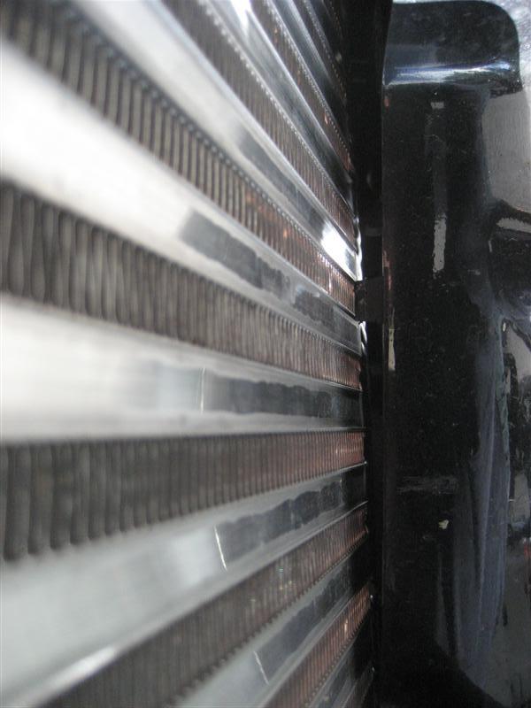

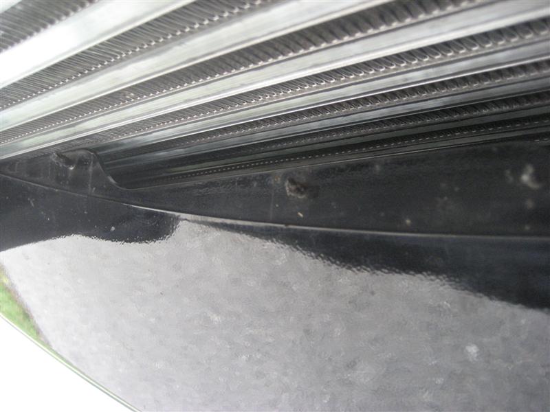

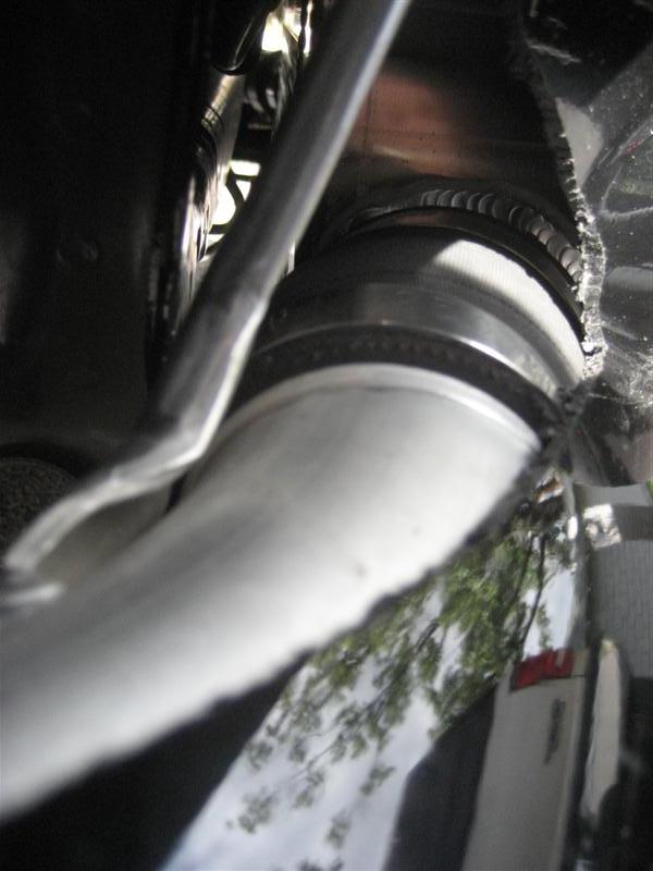

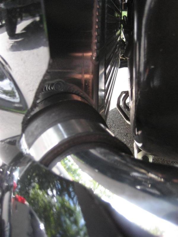

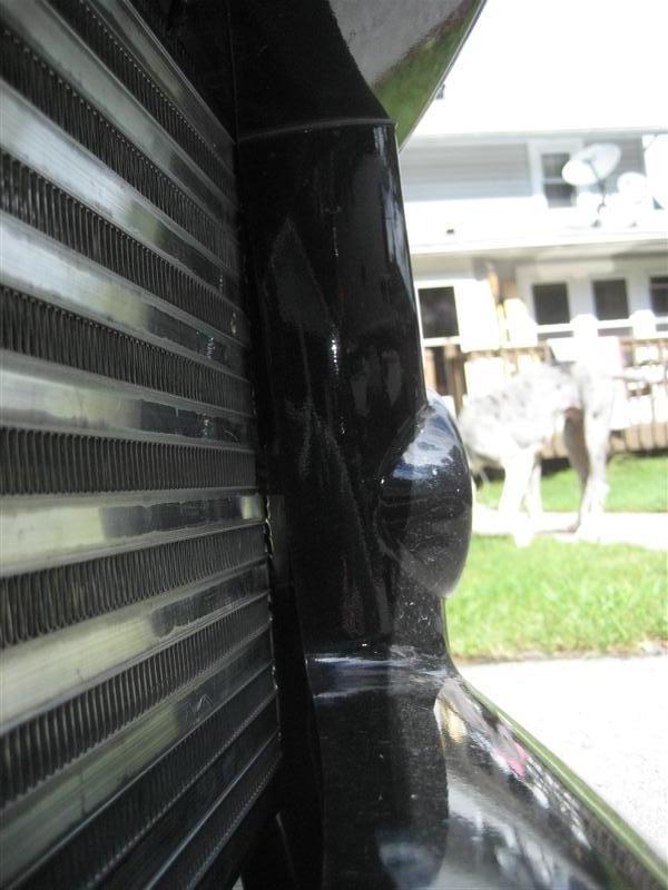

pics of clearances for those that say I need more research.
1. my bumper is touching the piping even with cutting it. the bumper would not go back into place without cutting it. look at these pics, its still touching the couplers even after trimming 1" out. yes, i need to clean the cuts up with a file i know... i will get to it eventually
2. look at the tabs for where the mesh would mount its pretty much touching the intercooler, i could have probably kept the mesh in, but why, especially if its going to be metal rubbing metal.
I think the intercooler fits pretty well for the size of it, and i'm completely happy with it. I would like to see pics of the modded crash bars, cause i cant even imagine it fitting without hacking it up sacrificing its rigidity, which would make it worthless anyway.
