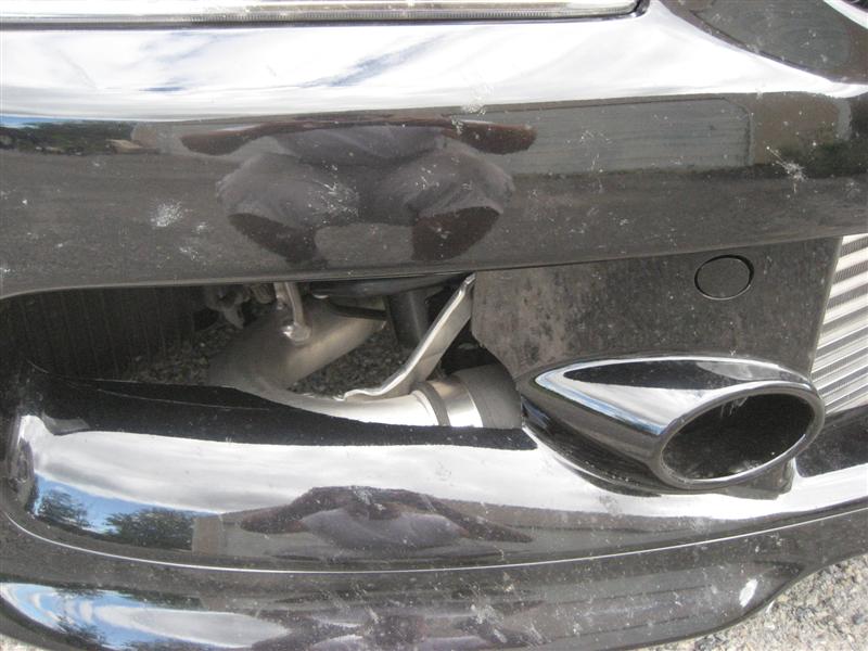

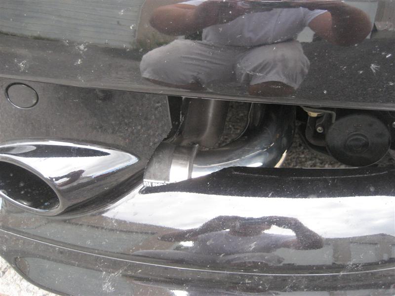

4. Left and right side ducts on the front bumper will need some trimming

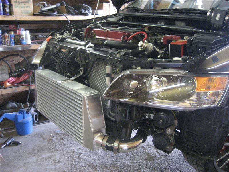

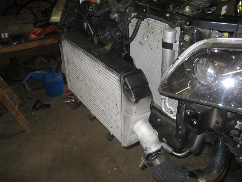

Stock intercooler in place ready to be removed

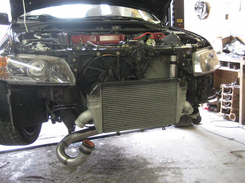

In this pic you will see the Buschur IX LICP - would not work as it curves up to mate to the stock style endtanks.

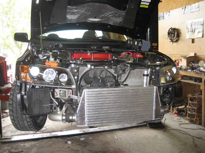

Buschur Race FMIC installed
Notice the stock LICP here. I had to bend the brackets on it to get it to fit
Trimming on passenger side (needs filed and cleaned up i know) notice the stock LICP for now =(

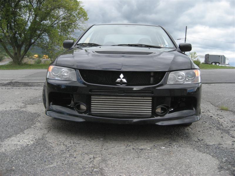

Trimming on drivers side

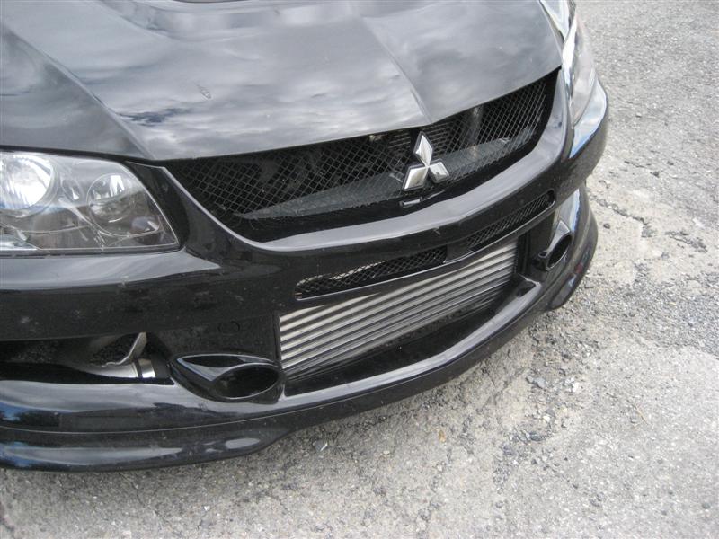

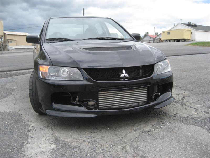

Finished product, my car needs washed, i know

I have the same fmic on my IX. I did not have to cut my front bumper cover at all nor did I have to remove the mesh. I even kept my front crash bar with some slight trimming.
Either or I love my BR fmic. It's amazing to feel the tempature difference between the inlet and outlet.

If you look at vwjeffs pics you'll notice that his fmic does not have the mounting tabs on the side like the one posted in this thread. Mine is exactly like vwjeffs. I have a feeling those tabs push the fmic out farther. But who knows.
