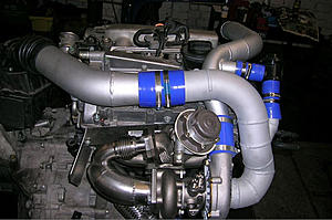

I think that you misunderstood me.... I m saying that all the valves I owned(oem audi and forge) can hold the piston upward after you pushed it. So basically, you push the piston inwards, shut the vacuum, and the piston will hold until you open back the vacuum. It is usually a test to check if the valve is sealed.
I am also sure that the valve is installed in reverse. So my questions are the same....In fact, i would most importantly like to know if the dv is damaged or not( hate them....).

I attached a pic that will help you see how the dv is installed.

Also one other thing I noticed in your picture...your diverter valve is positioned backwards. In effect the boost pressure is pushing against the valve while the vacuum is trying to open it, creating your flutter. Reverse the valve (the little triangle on the one port should be the side recirculating back into the intake tract) and it should solve quite a few of your issues.
