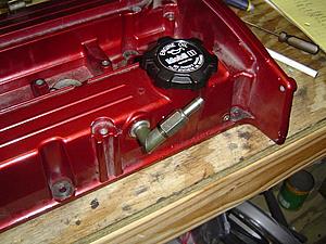

the ROCKER PCV VALVE(HOSE) on the back of the valve cover keeps sliding back. There is NO spring to hold it on, unless the spring is inside the cover. You guys don't know what ur talkin about. I intalled a WeaponR catch can and I guess it built up too much pressure inside the cover. Ergo(If you can understand that) the valve slid out spraying oil all around the dipstick and back of the motor. Hopefully you guys have learned something from this.

do you mean the actual metal pcv valve is coming out of the valve cover? Or do you mean the rubber hose that attaches to the metal pcv is sliding off?

Do you mean the elbow coming out of the cover to the PVC CHECK VALVE keeps sliding aft (out) of rocker cover? If so, should of asked that in the first post bro
To correct this I think we don't understand what you were describing, you finally pointed out important facts after making this comment. Go back and read your original question. It has no meaning. But now that you pointed out that there's a catch you installed that has become clogged perhaps someone can help you.
Worst case scenerio, if the PVC fitting keeps sliding out either zip tie it to the oil fill cap or replace your rocker cover. The other side of the PVC fitting is inside rivited chamber within the cover. Just zip tie the sucker - noone would care

yes, the plastic PCV valve (elbow)keeps sliding back, under normal driving. Does not come out any more during full boost. Maybe I have to get rid of the catch can?

I'm still confused, maybe I'm just dumb. But as I see it, it goes like this..... magnesium valve cover (painted red), pressure fitted aluminum fitting (bright silver), and then the metal pcv valve (a nice olive drab color). There is no plastic, or rubber, except for the hose that connects the pcv valve to the intake manifold. If the olive drab piece is sliding out, I don't know what the fix is, it's a pressure fit, and mine is tight as h&ll! I can twist it, but barely.
