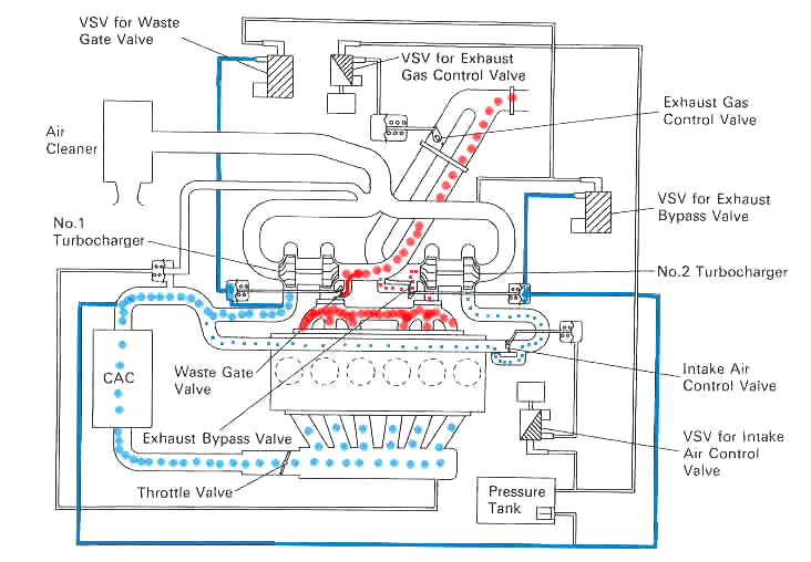

I have to agree that the length of pipe to get to the front of the car from the rear mounted turbo would NOT be sufficint to remove the heat from the intake charge. Maybe you could have it ducted mount an intercooler under the car. Your idea of having two turbos is a great one, however, I think that you maybe should focus on setting up a sequential system like the one found in the supra. It consists of two EQUALLY sized turbos. One always opperates, and the other only is engaged after around 4k rpm. The 1st turbo provides 8.5 psi while under 4k and then when both turbos are spooled manifold pressure goes to 10.8 psi. Obviously you would want to run more boost on an evo than on a stock supra, but the concept remains the same. The supra has an exhaust bypass valve that allows the exhaust stream to be split amongst the turbos.
Low end use:
Prespooling the second turbo:
Both turbos boosting
EDIT: You might find this thread helpful. They replaced the stock turbos on a supra TT with gt28s http://www.supraforums.com/forum/sho...d.php?t=444569
