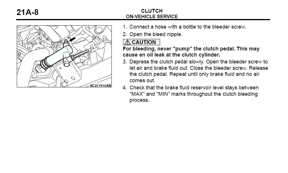

I don't see how a crush washer could be at fault here, if it was sucking air it sure as hell would be leaking fluid. I've found those speed bleeders only cause problems unless they're brand new. Try it the old fashion way again take your time and go slow. Manual mentions "air leak at the cylinder"

I've been using the stock bleeder and now a new stock bleeder(comes with New slave cylinder) I dont' mind being wrong in these situations. I have been bleeding the proper way( i think ) no air bubbles...pedal feels decent. We'll see once I get the word from mitsu.
