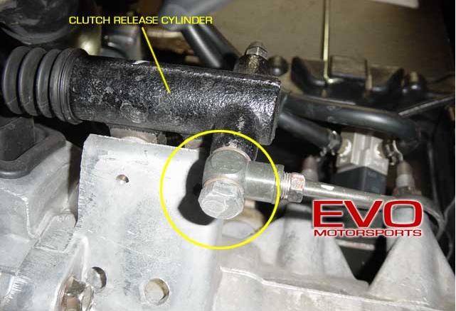

THese two here? or are you talking about like on the banjo bolts? Because both my sS lines and new Slave came with new washers.

or these two? Like i said earlier...got brand new ones from the slave.

yeah i bet u have a very very small leak. other that the crush washer you may want to make sure your bleeder is tight enough.

Yea he did all the basic bs...
I thought u said there's one crush washer u never swapped? Check there.. Wipe down every connection where it. Could leak the pump the clutch 30-50 times. Then wipe it down again. U should find some fluid somewhere. There's nothing else that could be ****ed up. You did everything except double check for leaks.
