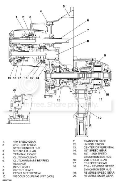

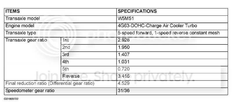

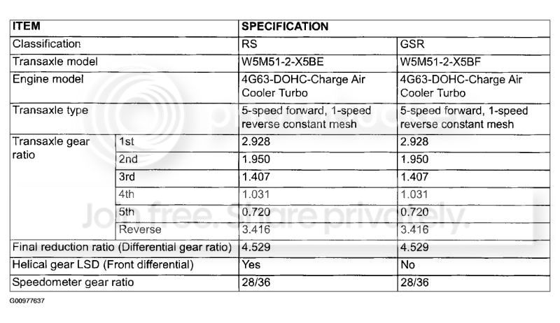

I went in to my service manuals and this is what I found the 03 Evo has no LSD in the front and a LSD in the rear.

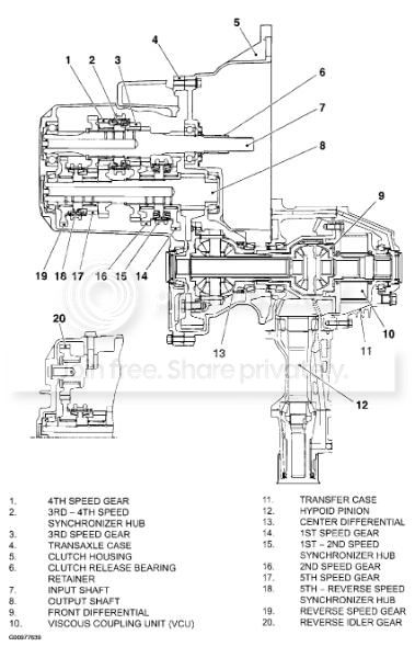

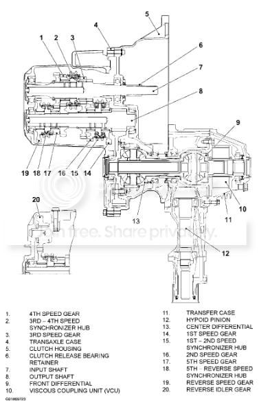

The 04 GSR was the same as the 03 but the RS has a Front LSD, both have rear a lsd.

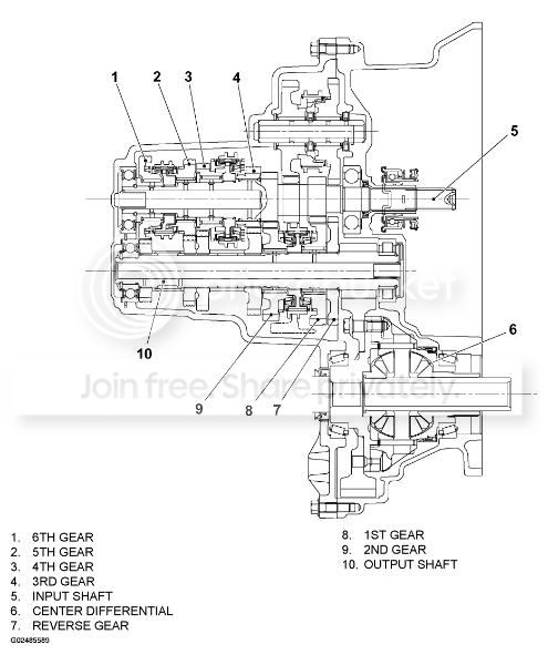

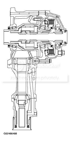

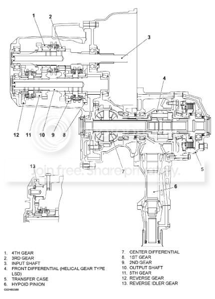

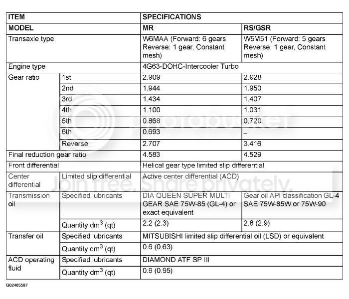

05 and up all have a front lsd and Active Center Differentials both on the 5 speed and 6 speed.
I printed these off of my service manuals so you can take a look.
03 specs
Notice the viscous coupling in the transfer case
04 specs
04 With LSD
04 without LSD
05 specs
Notice the viscous coupling is gone and ACD is now in place

Good info but its common knowledge to most of us here. Oh and The IX had some different gear ratios then than the VIII's as well

i was glad when i realized i lucked out with my 05...and yes the evo 9 got a different 4th gear, they usually put the evo 8 4th gear into drag trannys since its a longer gear
