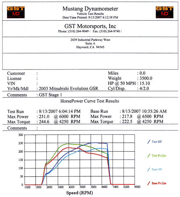

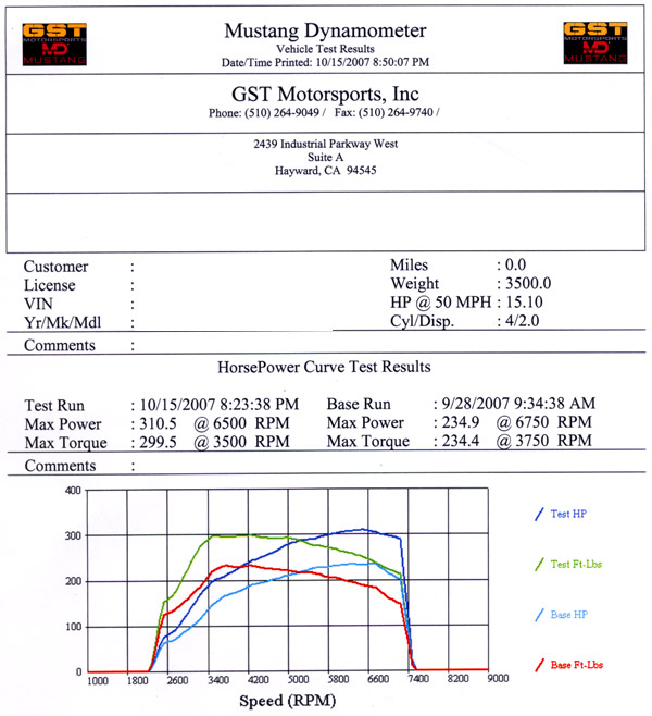

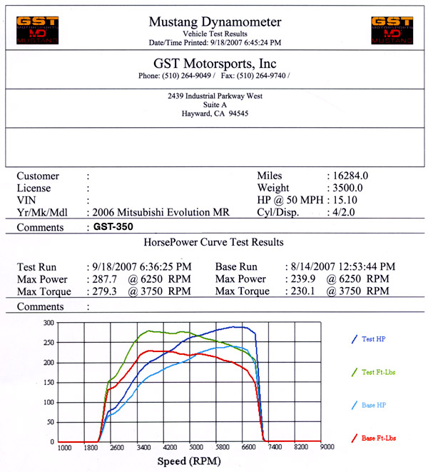

Here is some data to add to this thread that I have seen here in California on beautiful 91 octane.
First one is a 03 Evo 8.
base run is 100% stock with 30,000 something miles on it. This is the highest base run we have ever seen from a 03 Evo 8 so the after gains aren't huge. We usually see stock 03 Evo 8's do 190-210whp on our dyno.
So, base run is 100% stock, test run where with these mods:
1. TBE (tanabe 2.75" DP, Perrin HFC, Greddy Evo2 catback)
2. Blitz drop-in filter
3. Ecu boost assembly (upgraded pill) 21psi
4. Fuel Pump
5. Dyno tune
Of course peak numbers aren't always the name of the game, you will notice from the overlay, a large gain in spool and area under the curve, espically 5,000 to 5800rpm.

2006 Evo 9
Base run = 100% stock
Test run =
1. Boost assembly (ecu-controlled boost @ 22psi peak)
2. Blitz drop-in air filter
3. TBE (Tanabe 2.75" DP, Perrin HFC, Greddy Ti-C cat-back)
4. Fuel Pump
5. Custom dyno tune
+48whp / +49wtq
And of course the large gain in spool and area under the curve, espically way up top where the stock evo takes a nose dive.
2006 Evo 9
base run = 100% stock
Test run =
1. GM 3port Boost solenoid
2. Open air filter
3. TBE (Tanabe 2.75" DP, Test pipe, Greddy Ti-C cat-back)
4. Fuel Pump
5. RC 750cc injectors
6. Custom dyno tune
+76whp / +65wtq (Almost 100whp increase at 7200rpm and almost 90wtq gain at 3400 rpm)

Nice info Razorlab!
To summarize:
#1: bone stock evo 8 ---> tune, exhaust, filter, more boost = 34 hp
#2: bone stock evo 9 ---> tune, more boost = 32 hp
#3: bone stock evo 9 ---> tune, more boost, filter, exhaust = 76 hp
How come you think the #3 example was such a beast?
By the way that is real professional how you do the baselines like that. Very impressive stuff.
