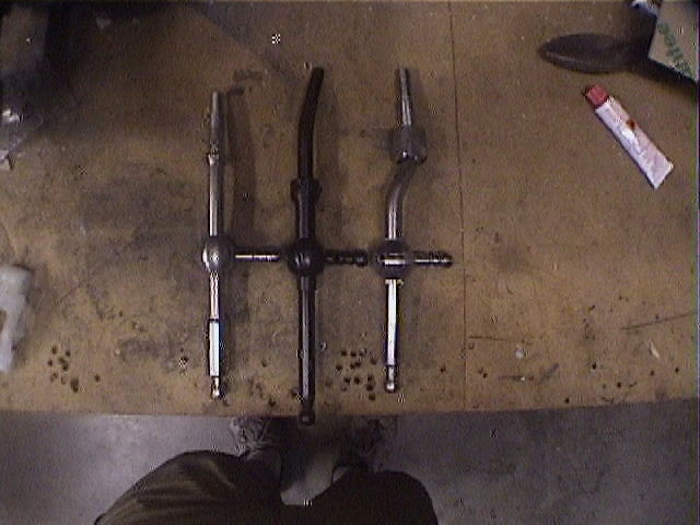

I recently installed a Perrin shifter and was given a B&M to try out, I took PICS of each shifter, showing throw lengths etc. I also discovered a couple of additional modifications that greatly improved the short throw action.
First the basic comparison;
The B&M does shorten throws by about 30% as advertised, but most of that 30% comes from shortening the upper shift lever (about 1"). This puts the shift lever in an even more awkward position for fast accurate arm movements, not good. The nice part about the B&M is that it is a direct replacement requiring no modifications.
The Perrin has wide range of adjustability allowing for very short throws and actually raises the lever higher than stock (very nice). You can also rotate the angled lever to change the relative position of the shift lever to suite your individual tastes(also very nice). The down side is that it does require a fair amount of modification and tweaking to get your optimum shift action, IMO it's well worth the effort.
The stock shifter is on the right, Perrin is in the middle and B&M left.

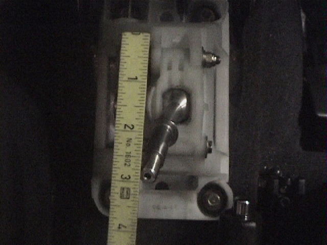

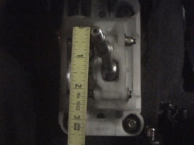

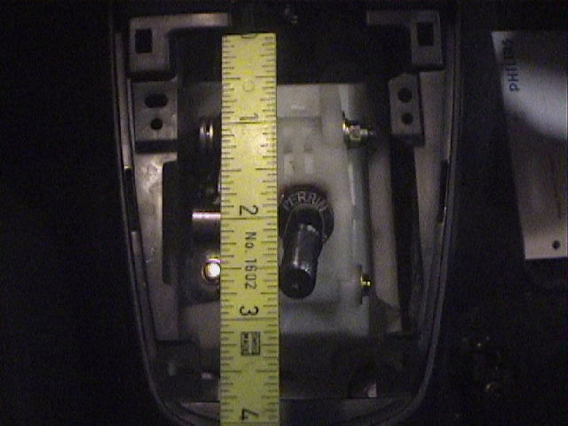

All shift throw measurments were done with the shift knob removed (add about 1" with the stock shift knob). Left to right movements are similiar for all the shifters with the B&M and Perrin less than 1/2 " shorter.
As you can from the following PICS, the stock shifter has about a 4" throw front to back. The B&M is about 2.75" (30% less) but again mostly due to the shorter top half. The Perrin was a little less than 2.75" but with an even longer upper half compared to stock. Later after taking these pics I found that you adjust the Perrin even further, reducing the throws to 2" (50% as advertised). see following pics;
stock 1st gear
Attached Thumbnails Short throw shifter tips/comparison-shifterstock-firstgear.jpg

Perrin 1st gear
Attached Thumbnails Short throw shifter tips/comparison-shifterperrinfirstgear.jpg

Perrin second gear
Attached Thumbnails Short throw shifter tips/comparison-shifterperinsecondgear.jpg

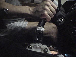

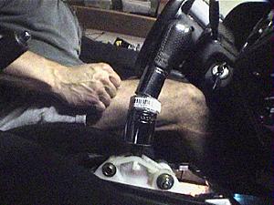

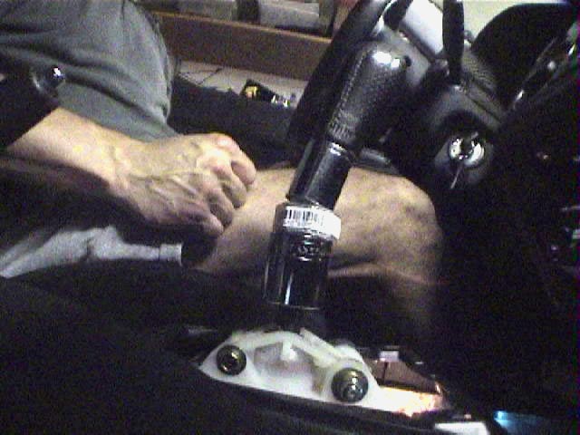

The stock shifter has a relatively long and easy throw, so having to reach down and bend your wrist slightly is not that bad. When you shorten the throws, the action becomes harder (more positive) and this movement becomes irritating. Also the stock lever has a counter weight, but both of these short throws do not. The counter weight helps to remove the vibration harshness generated through the linkage, and provide a smooth fluid motion. With the short throws this mechanical harshness is only increased (especially with the Perrin adjusted very short). So they have no counter weight and they actually need more, so your going to have to add some.
My first recommendation is to not use the stock shift knob. It's fine for the stock lever but it's still to short to get the optimum movement for fast effortless shifting, (and it weighs almost nothing). BTW the shift knob uses a 10 mm wit a 1.25 thread pitch.
I had an old FD RX7 pistol grip style knob (had to adapt it), it weighs over 1 pound and is about 4" long. Even with this knob I wound up adding almost another 1.5 pounds of counter weight, (see pics).
So now I have the shifter set to near it's shortest possible throw, and the bend facing forward. With the longer heavier knob (and additional counter weight) the shift action almost effortlessly falls into each gear and has a smoother more positive engagementwith shorter throws. I love it, (see pics).
Attached Thumbnails Short throw shifter tips/comparison-shifting2.jpg
Old Aug 7, 2003 | 02:01 AM
SILVER SURFER's Avatar
Posts: 559
From: D/FW, TX
first gear
Attached Thumbnails Short throw shifter tips/comparison-shifting1stgear.jpg

Second gear
BTW for the momment I am using a couple of large 1/2" sockets and a plumbing fitting for counter wieght.
Attached Thumbnails Short throw shifter tips/comparison-shifting1.jpg
